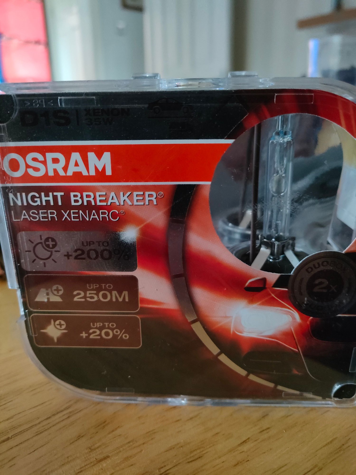

I can recommend these bulbs!
John: are the plug and play? Don't throw CAN bus errors?
Looked online...and they seem to be getting the mindshare going forward.
TIA..
