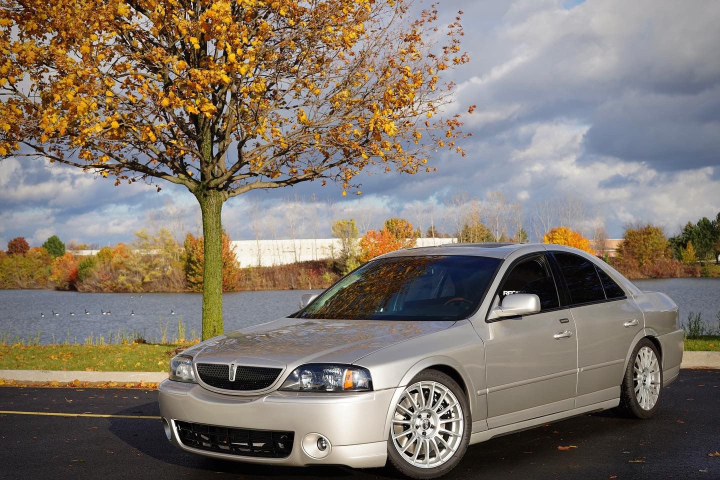

Coming in here a bit late but was going to link this anyway. SKM or "stu" developed a set of adjustable upper rear controls arms for dialing in camber, I had a ran a set on my (over 1.50" LS with coilovers) to get camber in spec. This, with the 8.8" LSD and 4.10's made for a hell of a LS. Compared to the R-S I have now it's not even close but thanks to Stu there is a somewhat viable solution out there. Anything can be done - depends on how much you wanna spend!

Good looking LS, and it brings back pleasant memories of our car. It's hard to believe that 25 years have gone by, since we purchased our LS, and 16 years since we traded it off for our XF.
