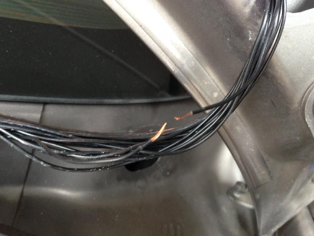

Not sure what you have done? But the wire loom going into the trunk flexes and over time the wires break. Replace the loom or cut it open and find the broken wires.
Fairly common repair on those cars.
Here is a picture from the thread below. Not sure why Jaguar made ALL the wires black!

Thanks but loom already changed
