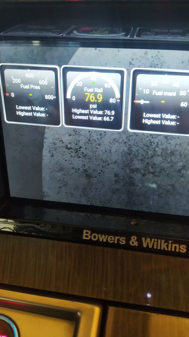

Here is some additional info.
fuel pressure reading with ignition no.
Fuel pressure reading on start up.
Fuel pressure reading after warming up.
It's like it never happened everything seems to check out fine, I'm just feeling unsafe driving the car if this happens again on the highway i might not get so lucky.
