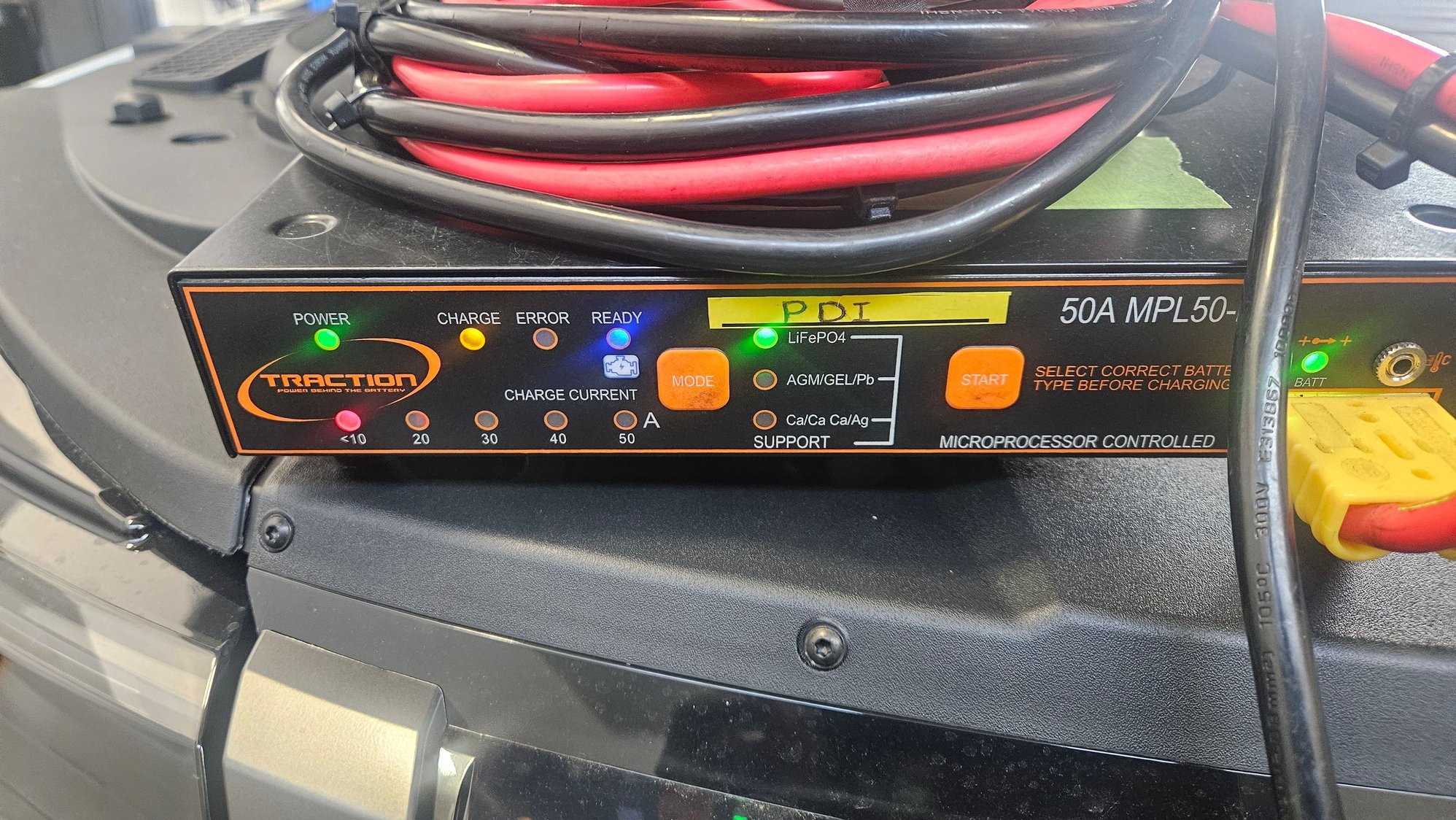

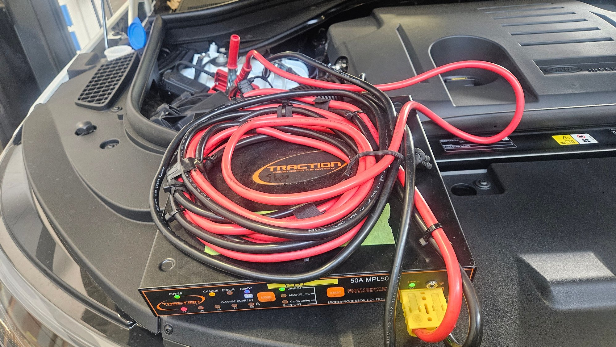

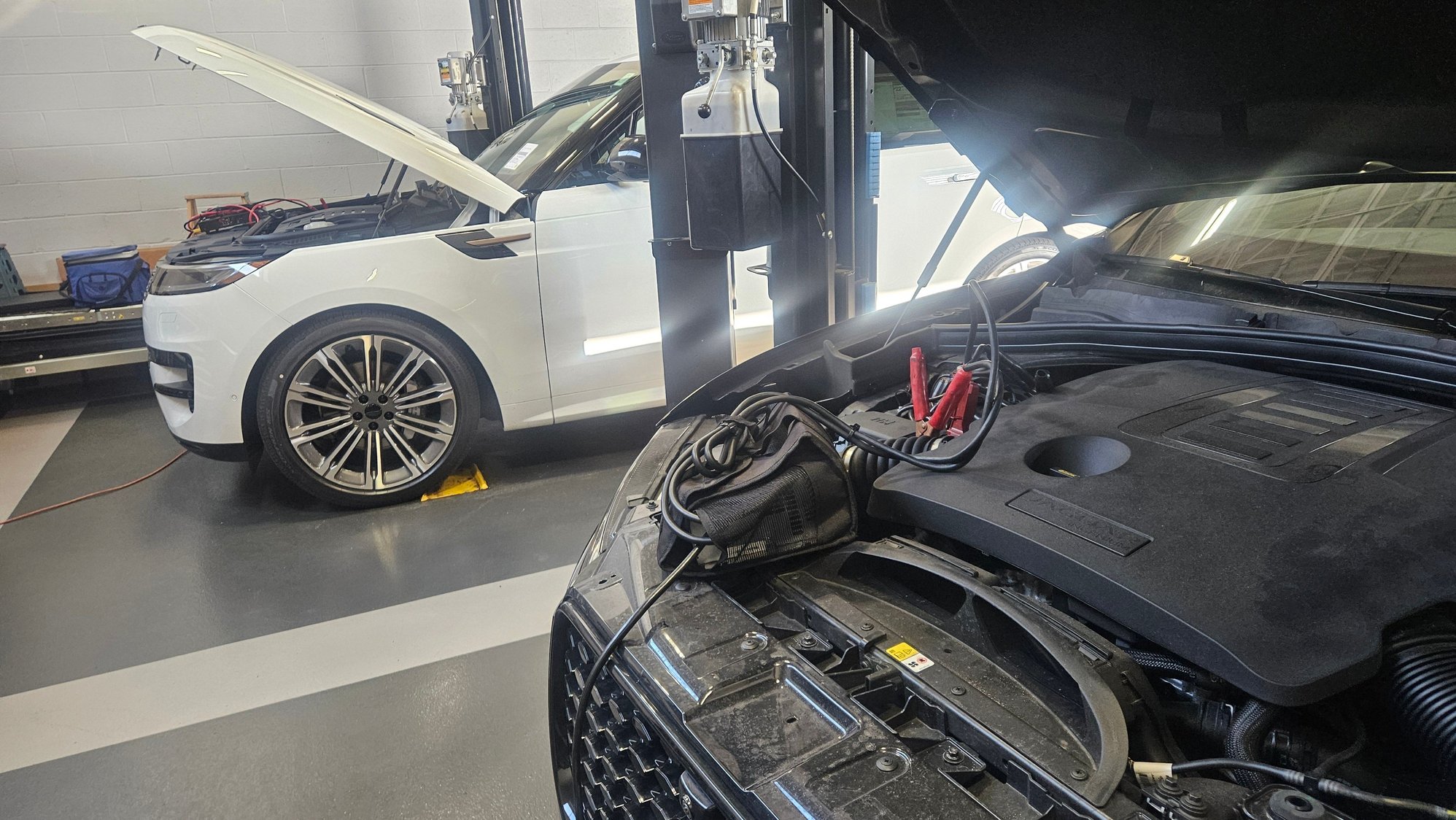

No chances in this procedure, have a battery maintainer and read as much info on this,
And make sure the top right has green on the battery like in this image

Again and again NOT a battery maintainer!! Read what JLR wants when using SDD. A DC power supply with at least 30-50 amps and low ripple. Many disasters have been caused by this. When programming this ripple measurement is critical.
