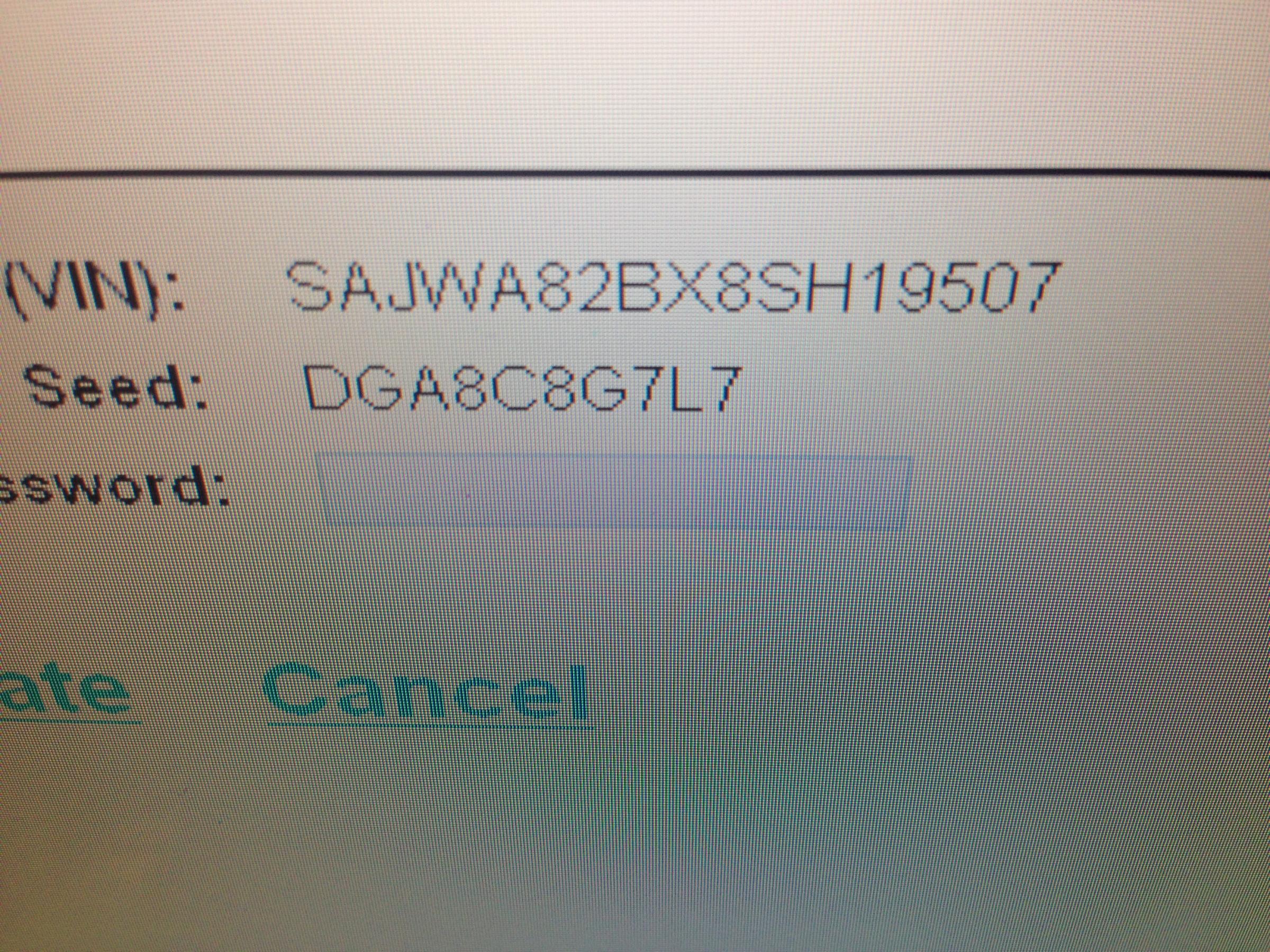

Good evening forum members.
I purchased a gorgeous 2008 VDP last month which came with only one semi functional key. The dealer who was 2000 miles away sent me another newly cut key but explained that the keys would have to be programmed by a dealer. I've read here that this is possible using VCM with the proper IDS software. What I see when I connect the VCM to the car is a basic diagnostic menu, but no access to creating a set of keys. There is a gold key on the main page which I believe leads to coded functions. However it is asking for a password to a specific seed number. Is there a calculator available for this, or can anyone who has godlike access, please help me?
Many thanks -- I have attached a photo of the seed screen.
Cheers all!
Chris

Hi Chris,
This should probably go in the main thread https://www.jaguarforums.com/forum/g...e5/#post602124 you should have a read through that thread before getting too deep into SDD. If something goes wrong you could have a very immobile pile of aluminium & plastic sitting in your driveway!
Forget about the Golden Key that's the engineering mode & it's not what you are looking for....
But first things first, does the new key the dealer sent you start the car? If it does then you only need to reprogram the remote, and that can be done without SDD, have a look here https://www.jaguarforums.com/forum/x...-2005-a-34092/
If the key does not start the car, then I have to wonder why the dealer even bothered....
To reprogram the key transponder (in the key itself, not the remote) you need to open a "Service Session" in SDD, after going through all the scans I think it's under Extras or Service Functions, you should see the option to program a new key.
Or maybe you will have to go through a "Diagnostic Session" and select a symptom of key not working or something like that, which will then bring up a recommendation to reprogram security or something similar. Sorry I don't remember exactly where it is now.
You will have to reprogram any other keys for the car at the same time, or the others will no longer work.
Make sure you have a battery charger hooked up to the car, and your laptop is running off mains power.
As I said there is always an element of risk while playing around with these things, if the software crashes or locks up in the middle of programming, it can mean having to reprogram the whole car.
Be careful!
