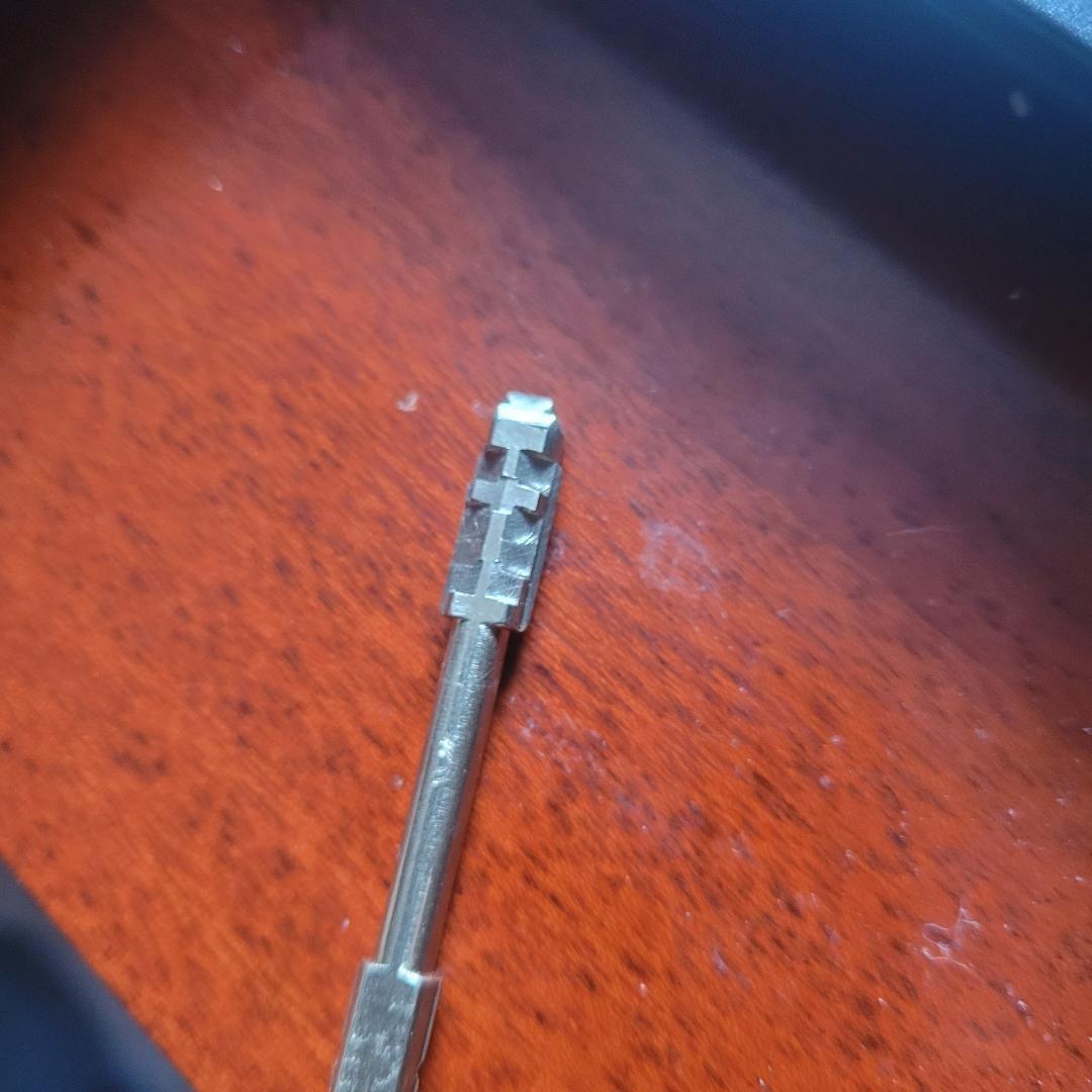

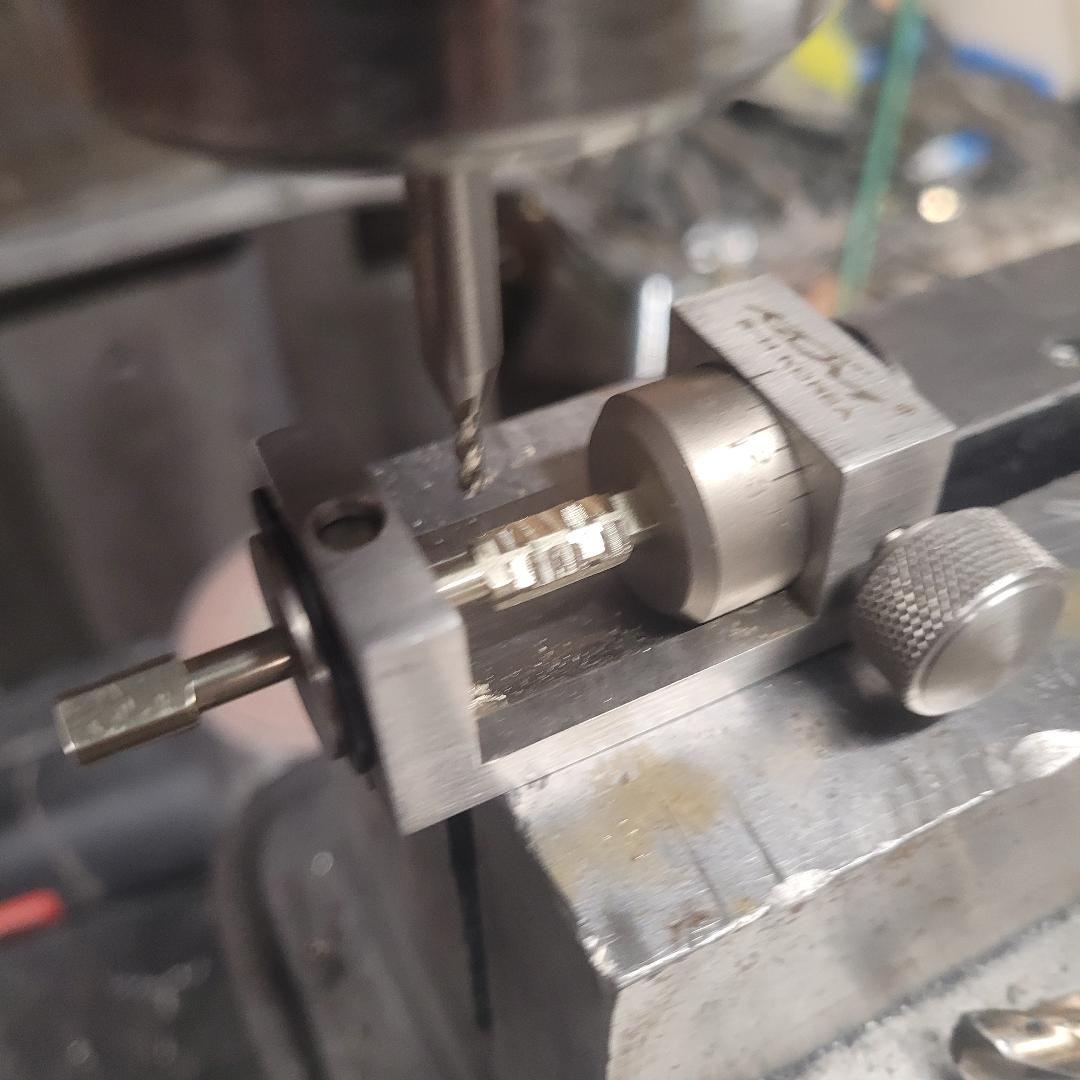

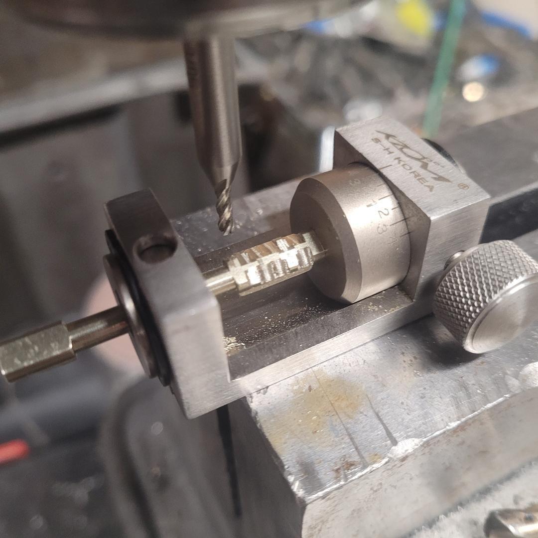

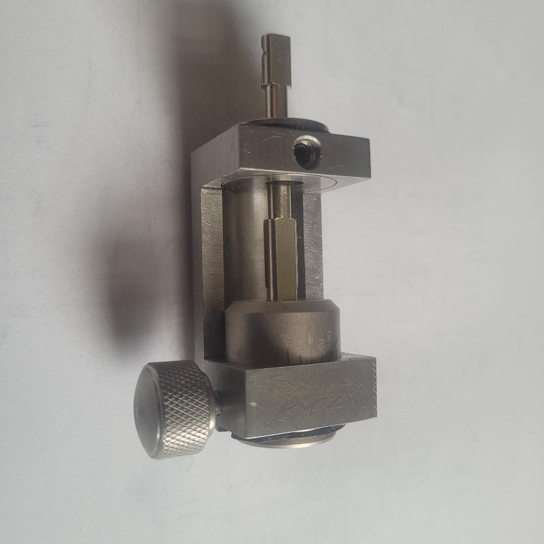

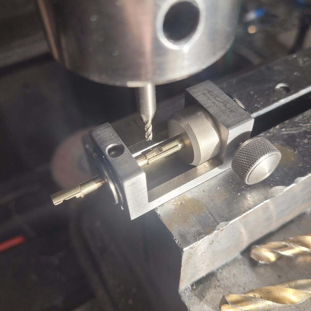

My first cut key works! My Klom Tibbe key fixture arrived today. I set up the fixture in the mill vice. Most of my time spent was creating a conversion chart that converted metric numbers to English so I could use my digital table position Indicator. - About 20 minutes in planning how to cut the key, 15 minutes setup on the mill, 15 minutes to cut both sides of the key. Easy-peasy - very simple mill job.
- Next step: I will confirm the key code from my Tibbe pick that I wrote down for my lost key, and then cut a test key to be sure it works. If it works, I will cut the 2 keys on my new fobs.
Edit: I cut a test key for my missing keys on my X-type: Perfect fit and it opens the door and turns on the ignition. Tomorrow, I will cut the 2 keys on my replacement key fob assemblies.
(Now that I have the cutting process down, second key took less than 10 minutes to cut and wire brush clean.)
