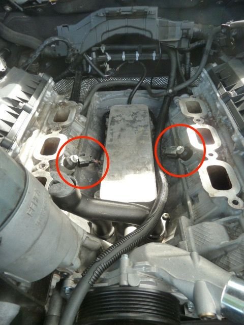

somewhat 'good' news. He will proceed to replace both knock sensors and keep me posted.! He is going to replace both knock sensors,!! while removing the supercharger and air cooler. see below! seems expensive if (should) the engine is (be found to be) terminal?
Knock sensors ringed in red.

This knock sensor replacement seems like a lot of work to Not find the reason/cause of the knocking noise coming from the engine.
