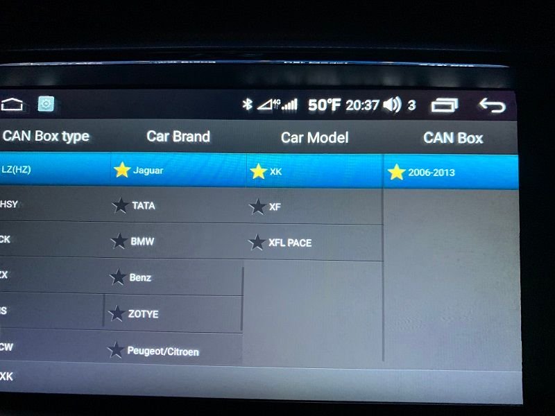

A new unit has been installed:https://aliexpress.com/item/1005003933721351.html

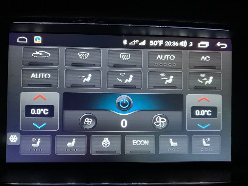

2) please activate heated steering see if it shows up in the AC menu.

Unfortunately parking sensor doesn't beep in front, but it works graphically.
Steering wheel icon comes up when selecting XK

​​​​​​The older unit also showed up the heated steering icon when selecting XK.
