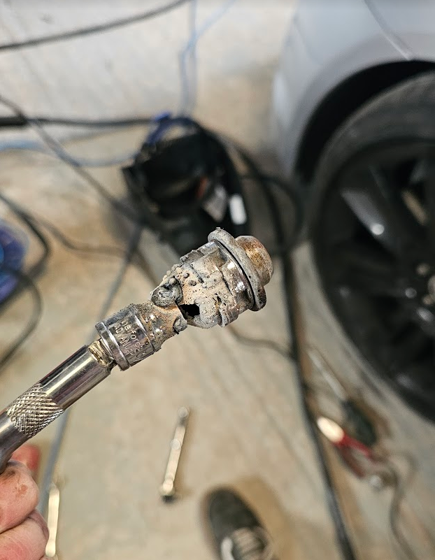

we the dealer have a master set and can take any jaguar land rover lock off. Or knock a slightly smaller socket over it with a hammer and take it off with a ratchet like the thieves do and throw that crap away. Put the 4 lug nuts back on that should still be in the box the locks came in, usually in the trunk. If youre one that just "feels better" with locks i have a new jaguar set for $25

i can get those off too, just pound a smaller impact socket over it. It crushes the outer collar and bites in underneath. I have those on my nissan and forgot where my key was once....
Fair enough buddy.. some people states that it only turns the outer cover. But u r right, today once i saw the nuts in my hand, i understood how it works and realised that it could work. Or maybe even those sockets advertised on fb.. the one that fits any shape..

yeah i bought those for my custom offroad beadlock wheel and couldnt find the key when i cut a tire in moab out rock crawling and had to change out offroad. One of the other wheels had a slightly smaller impact socket so was worth a try. Pounded it over it crushing that rotating sleeve onto the piece underneath and viola. Came loose with a 1/2" ratchet. Oh well. I dont think that one pictured would do it though. Those a primarily for round heads and i have broken several of those. They always work great in the ads
