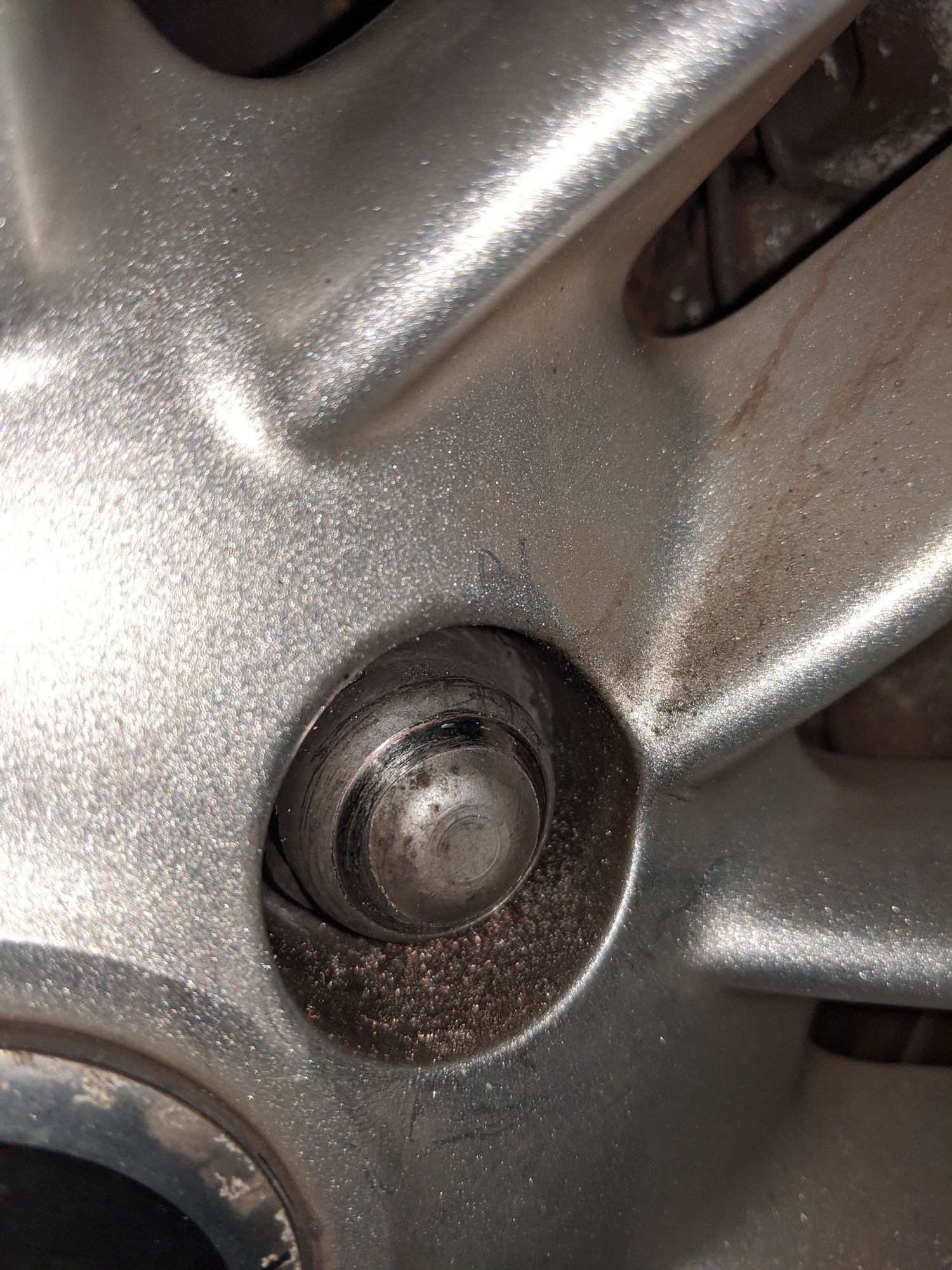

Hi John,
I couldn't cut a hole at all, even I tried to saw it for nearly 10 mins. Am I doing something wrong!
Please have a look and advice

Originally Posted by W.Dabbas
Hi John,
That "locking" lugnut SHOULD be hardened steel, so there's NO WAY you should be able to do and damage to it, with that saw blade. My suggestion would be to get a hold of a 6 point socket that a BIT smaller than the OD of your lugnut, one that will fit by POUNDING it in place, then you should be able to remove it by spinning it off.
This brings up another question....do you need to remove 3 more locks? If so, could you post a picture of them, so we can see what you're working with?
