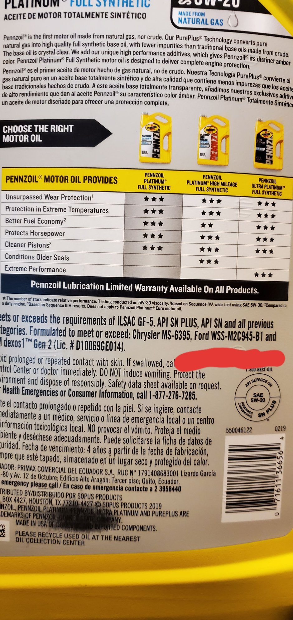

the oil got some 5w20 pennzoil platinum but maybe should've got the extreme but well just wondering if its up to spec, and ill post a pic with the specs on back of the jug so just wondering if its good enough, it was pretty good price thru Walmart 2 of them came out to 40 bucks for the 5 qt size

and ill post the specs of the pennzoil if its good enough

What engine so you have?
Jaguar recoemnds the 0W-20 for the 3.0 and 5.0 SC engines
JLR STANDARDS ACEA C5 SPECIFICATIONS JAGUAR LAND ROVER – STJLR.51.5122 for the Supercharged engines.
As well as GL-5
I only see the following on the Pennzoil A5/B5-10, A5/B5-12 (SAE 5W-30, SAE 10W-30*)

thanks for the info on that , i wish i had the SC engine, i have the 5.0 NA portfolio , i dont have owners manual so i go buy what i can find on the net and these kinda forums.
have read that theres no real info on what oil meets or exceeds that standard but most places ive read and researched stated this was a very decent oil for the jag at 5w20.. almost made a mistake of putting 5w30 in it; it was mobil 1 and got it at a great price for the 5qt jug for 2 for barely over 40 bucks but then I reread it amd was 30 not 20 🤦🏻‍♂️

You were close on the Pennzoil. You need the Ultra Platinum to meet the spec.

does it make a huge difference or any difference really betweent the 2?
I just know what i get from these types of forums etc.
it was just that I read that the spec i underlined on the bottle was an updated version for the specs for the jaguar
i mean i dunno
and thanks again!

I did a ton of reading here and elsewhere on the net about the spec and didn't find anything definitive.
Conclusions (opinions?) I have formed from the research:
If you want to go 15,000 between oil changes, you need to use the right spec.
There was a thread where it was discussed that Jaguar has a patent on something timing related and the oil spec had something to do with keeping that part of the engine functioning properly. Beyond that thread, I couldn't find anything to back up the claim.
945B did not replace 925A. When 925A expired, JLR swapped to their own specifications:
STJLR.51.5122 for 0w20
STJLR.03.5004 for 5w20
On the newer engines (2014+ I think?), JLR recommends 0w20. This is what the dealership will put in your car if they do an oil change for you.
As near as I could tell, the only oils available in the US that meet the spec are Castrol Edge Professional (only available at the dealership) or Pennzoil Ultra Platinum. There are a number of European brands that you can order from Amazon that also meet the spec.
Personally, I don't think you'll do any harm running the Pennzoil Platinum in your car. I wouldn't try to do 15,000 miles on it, though.

Pennzoil platinum is an zwesome oil, use a high quality oil with the right additives and you will be ok. 5W-20 vs 5W-30 are negligible ( check out bobistheoilguy.com) The 30 weight would be good in summer ( I would avoid in winter) and good expecailly if you push the card hard in warmer temps

i guess ill be good for at least 6 months using the platinum then after ill look for the ultra on sale or whatever else thats for spec

Pennzoil ultra is not readily availalbe in the states is it ANd thier SPEC oil is the one that matches JLR
I would never run an oil for any more that 7500 miles (half the OCI that Jaguar recommends) I run may cars up to about 250K miles (or until I hit a deer)
