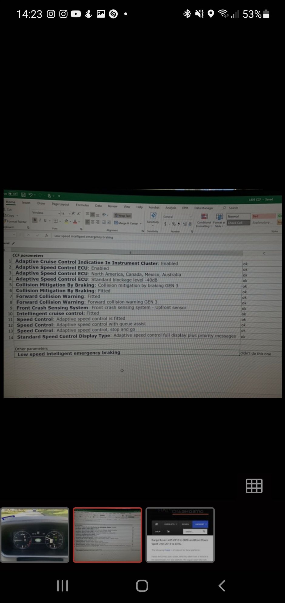

Don't suppose you know the top of your head which settings I need to enable on the CCF, I have a screenshot but it's from a Land Rover page so not sure if it's the same!

Not off the top of my head. It's only seven parameters though. Eight if you're doing a proper job and adding Active Seatbelts.
Only 7, okay thank you, i'll keep that in mind!
