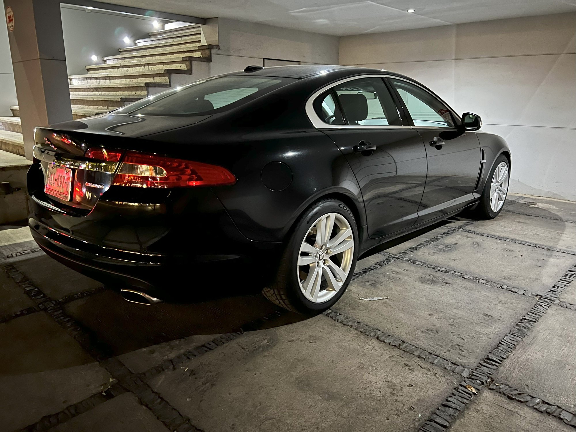

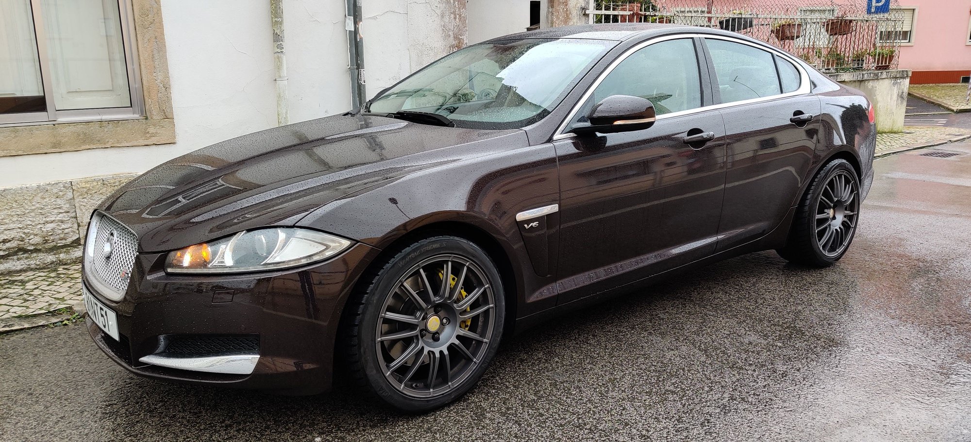

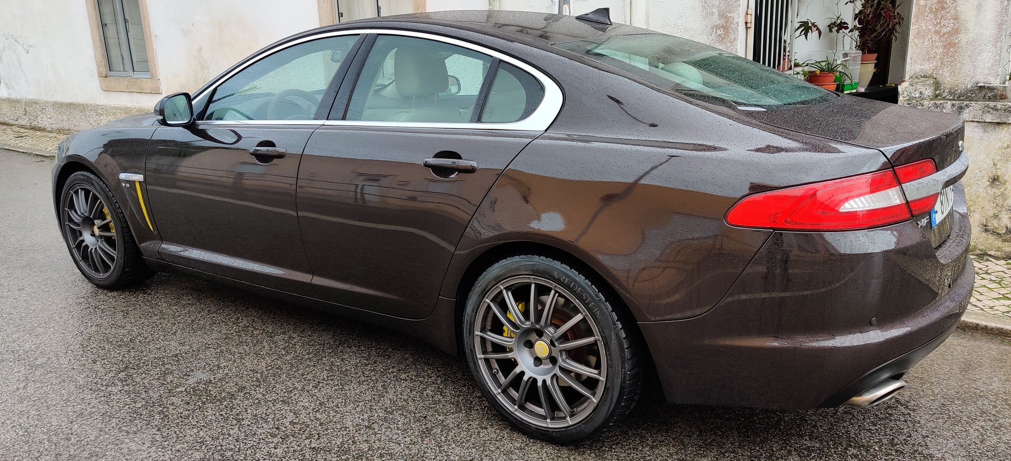

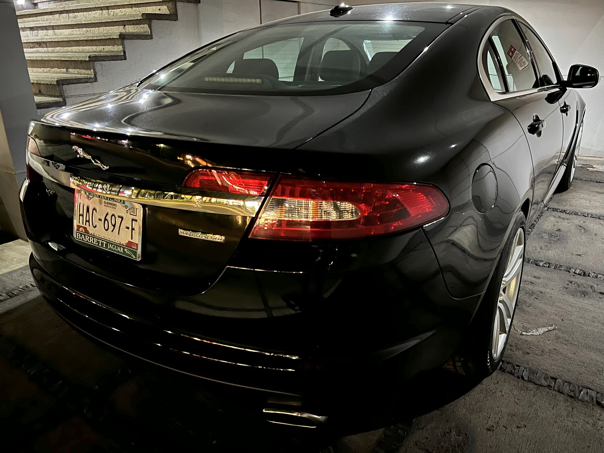

I just swapped out my tires for the right size for these rims.
The front still have the 245/40R19 and on the back I got 275/35R19
Flush to the fender on the back with no rubbing whatsoever, so if anyone can use this info and is looking at some rims from a F-Type to put on the XF, it's confirmed they will fit and in my opinion they look awesome.
That does look great. Can you share the specs on those wheels? I see they're both 19". Model? Offset? Whatever you have. Thanks.

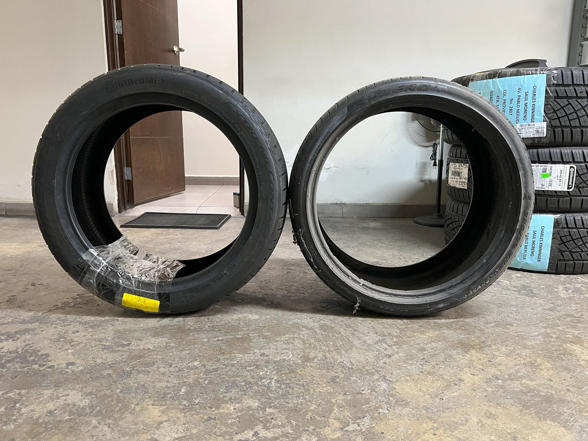

Thanks for clarifying. I had never seen your rear wheel specs referenced besides your post. As stated, my OEM are ET66 in rear (9.5 x 20). ET66 range are tough to find! I needed to find out exactly how much fender clearance I had. How much more a wheel could extrude without rubbing the inner fender when the wheel hits a bad pothole.
With the car on the ground, I measured the clearance of wheel face to inner fender at 20 mm. In other words, at rest I measured the outer wheel 20 mm less than "flush" with inner fender. FYI I used a level and a ruler to measure.
Then I took the car to a shop (see photos below), lifted it, disconnected the rear shock/spring, lowered the car until the rear lower control arm rested on a ground pole support, then lowered the car further until the wheel raised in relation to the fender. I would estimate the wheel raised approximately 5 cm upward toward the wheel well from normal ground position. The wheel does lean in (camber) as it raises. At the point in the pictures below, I measured there to be 32 mm horizontal distance from the top of the wheel face to inner fender.
If the wheel were pushed higher the fender clearance would have increased. One could use geometry to figure more information. For me, the 32 mm of fender clearance is enough for what I'm trying to add.
I'm adding 20 mm for having only ET46 offset (was ET66) on the new wheels (2013 Jaguar XJ Porftolio OEM 19x10) and an additional 1/4" (6.35 mm) due to the wheels being 1/2" wider than the OEM 20x9. So that's adding 26.35 mm extrusion but I have more than 32 mm clearance according to my calculations. Another factor leaning in favor of the new wheels and tires fitting is the new tires should be about 10 mm less wide as was stock on the new rims.
I'll post here after everything is on and tested. Thanks again for the specs and information.

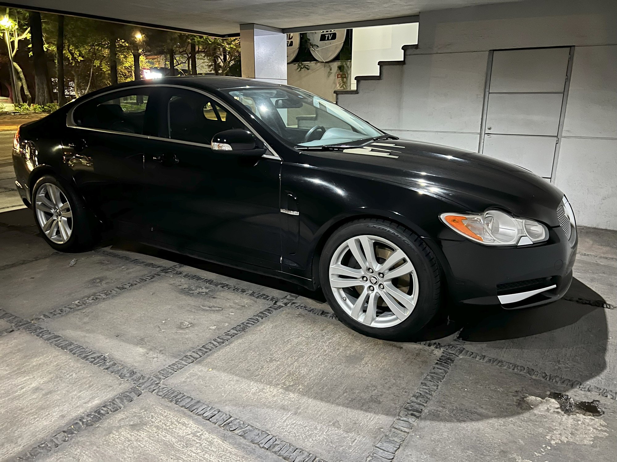

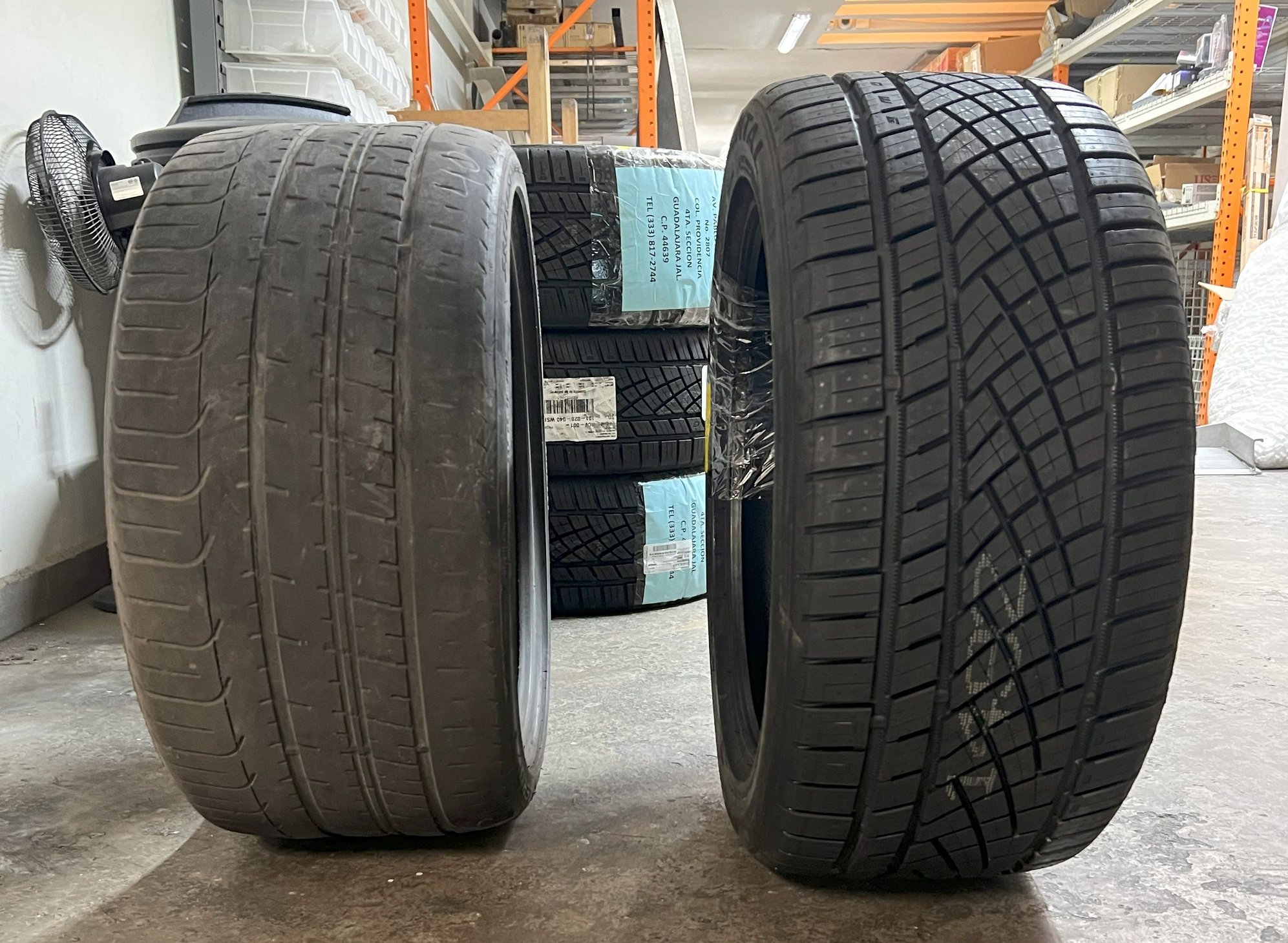

2009 XF SC
Stock
Front
255 35 20
8.5Jx20 ET49
Rear
285 30 20
9.5Jx20 ET66
New (FROM 2013 Jaguar XJ Portfolio - tire sizes stock for that model too)
Front
245 45 19
9Jx19 ET49
(15mm Wheel Spacers)
Rear
275 40 19
10Jx19 ET46
NOTES: It's not as nice looking as it was with the factory 20" wheels and very low profile tires but after 15 years I finally have a smooth ride on the very uneven streets of Guadalajara Mexico. No hints of rubbing. The cost pill was easier to swallow as I picked up the OEM set of wheels for $500 USD on eBay while the old wheels had cracks and worn down tires.
For Comparison:
