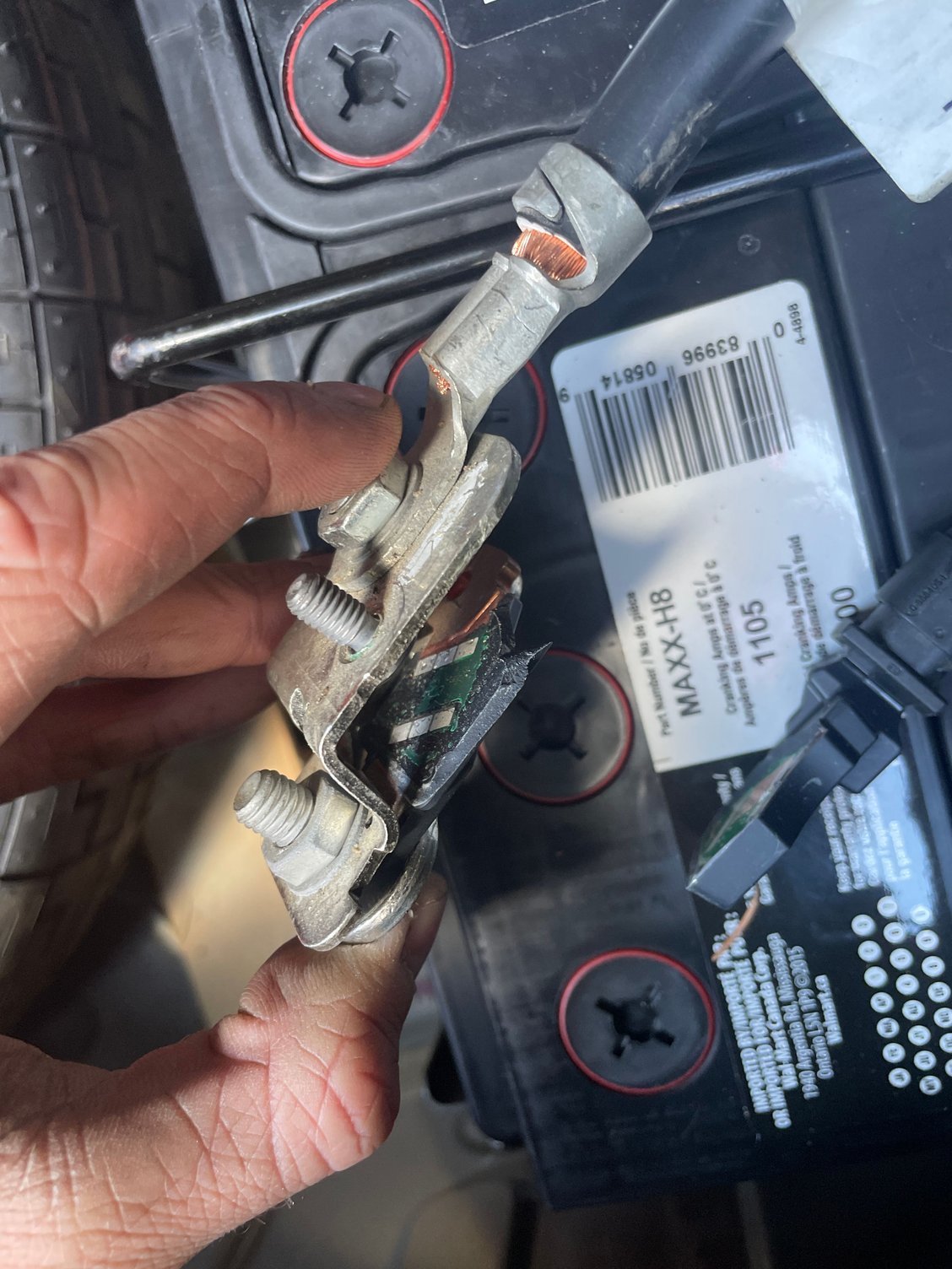

So I bought a new battery as advised, which it was definitely due, but I’m still getting the battery not charging light. I believe it has something to do with whatever the heck this is. It seems like it should sit inside the terminal clamp assembly but I don’t know how to line it up and there seems to be nothing to clamp it?
That thing is the guts of the BMS (Battery Management System) module and it is FUBAR, no wonder the battery is not charging!
You are gonna need a new module and I have no idea how much that will cost or where to get one from.
Be prepared to pay through the nose for one from any JLR dealership.

Thanks for the pic! As noted above it's clearly broken.
I believe the part number is C2Z16597.
Yep, that's it!
A quick search brings up this: https://parts.harperjaguar.com/oem-p...l-end-c2z16597
So not all that expensive and it seems to be a doddle to fit, literally plug and play.
Worst case scenario is that it will need to be reconfigured by a JLR dealership = more $ and inconvenience.
Edit - forgot to add - it appears that the module was smashed by whoever fitted the new battery so you may be able to get recompense from them, especially if it was a JLR dealership. But if you did it yourself obviously no come back!
Edit 2 - it looks like whoever removed the old battery simply undid the negative terminal clamp without undoing/removing the negative cable nut which bolts onto the BMS module, then yanked/twisted the cable and hey presto one smashed BMS module.

Appreciate the help guys! I threw the new battery in myself, I’m a pretty handy guy I’ve been wrenching on cars since I was a kid but the module wasn’t even inside the terminal clamp in the first place so I assume the previous owner but have wrecked it as he had a sub wired into the back. So that part # is for the clamp or the module, the link brings me to a the clamp but I would also need the module correct?
EDIT - for some reason the link was showing me a negative battery cable, but I searched the part number and found what you guys are talking about, the module is attached to the battery clamp so I’ll just have to bolt on the new clamp to the cable and plug it in. Easy stuff thankyou
