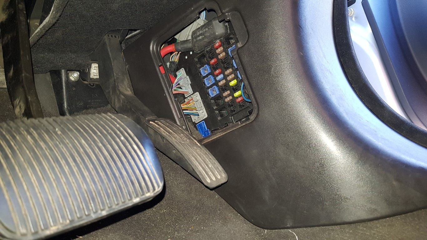

The simplest way to get power on to the car is via the front fusebox/CJB. It can be a little awkward attaching a clamp to the positive terminal but is not hard and the door "check strap" bolt - not the strap itself - is ideal as an earth point for the negative clamp. Open the fusebox hatch near the accelerator pedal and look inside or feel for the rubber cover near the top of the fusebox assembly. (one can see it immediately above the fuses in the attached image). This can be pushed aside to expose the nut which secures the thick power supply cable to the fusebox and attach the positive or red clamp. There is no exposed metal anywhere near so there is very little chance of shorting anything out. Attach the black or negative clamp to the bolt on the door check strap and finally attach the leads to the battery or power source making sure you get the polarity right..
Dont try to use this to jump start the car but press the boot release button with your nose if need be and the boot will open. You could have someone else press the button on the boot or press the button on the remote.
Thats it - job done. Now you can access the battery to jump start or charge or remove.
