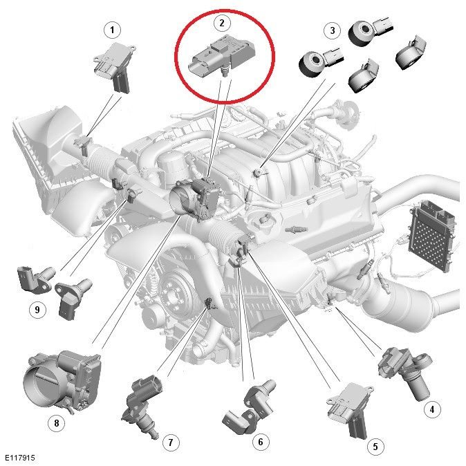

Okay after some quick research, I'm thinking that the P1118 code is referring to the MAP sensor, which sort of makes sense because I have noticed that the gas mileage seems lower than what it should be. My local autoparts store sells the replacement MAP sensor for around $130. Should i try to replace it and see if that does the trick? If so can someone point me in the direction of where the MAP sensor is located?

Here is a sensor layout for the 5.0L SC and I think yours is the same. Should be simple to see if it's in the same place. Pretty sure it is?
