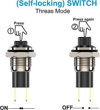

There's several other threads on this. I've tried some of the suggested solutions to no avail. Whenever its really cold or really hot, the sensors are ghosted. Once the heat/aircon is running and the temperature inside the car stabilizes to a more moderate temperature, then my map lights settle down. My thought would be to figure out how to bypass the stupid sensors and just install tiny latching push-button mini switches, something like this:
Amazon Amazon
But I have several other busted cars and a million other priorities so I haven't messed with it yet and will probably trade up to something newer before I ever get around to it. I keep hoping somebody else would figure it out first and post a how-to, then if it made it easy enough and looked clean enough (selecting the right style switch and the right spot to put it could take weeks of research and possible multiple purchases), then I might follow suit.
