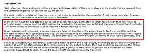

There's lots of information on seat faults in the Workshop Manual.
Going through it confirms that seat travel is controlled by Hall Effect Sensors. These are known to be prone to faults from physical damage or even just getting dirty.
One of the first tests, before having to resort to a scantool to check for error codes is 'stall detection':
Try this technique and see if you can get the seat to inch forwards.
Attached Thumbnails Power seats will not slide all the way forward-stall.jpg

Thanks, continuing to push the button forward a few seconds worked. Seems simple, but not knowing I never tried, so glad there was a simple trick to fixing this!
