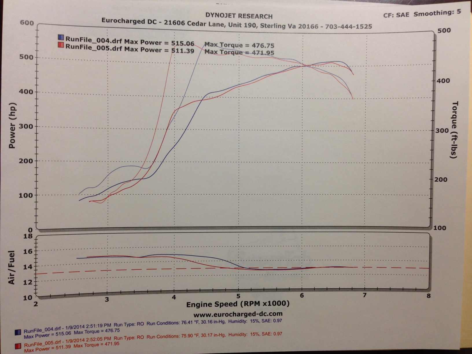

I know there has been a lot of discussion on these boards related to ECU tunes and the various vendors offering them, so I thought I would relay my experience as well. I took my 2010 XF Supercharged to Eurocharged just outside DC today. Overall, a very good experience and impressive results. I had the pulley installed and ecu tuned. Jerry from their Houston shop was in town and did the tune. I will post the dyno sheets below (not sure how I left without the before and after pulls on the same sheet, but you will be able to see the results between the two sheets). In short, the best stock dyno runs showed 393 rwhp and 378 rwtq. The best post-pulley and tune dyno run showed 515rwhp and 476 rwtq. Overall, a very impressive improvement and very noticeable on the road. The first attachment shows two baseline pulls and the second attachment shows two post-tune pulls. Hope this information is helpful to those who are considering this mod.
Attached Thumbnails Pulley & Tune @ Eurocharged-photo-1.jpg   Pulley & Tune @ Eurocharged-photo-2.jpg

Congrats, those look like good post tune numbers even though your baseline looked pretty low compared to other dynos I have seen.
I bet you can tell a big difference in the way she runs now. I also had a good experience with Jerry at Eurocharged Houston. Thanks for sharing.

Thanks, Matt. You also have to remember that I have a XF Supercharged, which is rated at 470hp and 424lbft from the factory, so the baseline #s seem pretty good (about 16.5% drivetrain loss for hp and 11% loss for torque). There may also be a difference in the dynos. This is the same dyno that UsmaXKR2010 put down a 373rwhp and 340rwtq for his XKR baseline. Seems like it will always be a struggle to get an apples to apples comparison for those of us that are in different parts of the country, but I'm definitely pleased with the overall increase and impressed with the folks at Eurocharged.

122rwhp & 98rwtq from a pulley & tune, that's quite a result. Thanks for sharing!

16.5% loss sounds about right. What pulley did you install (usually there are two options)? Thanks for sharing. That should be a night and day difference.

Yup that seems about right. I was thinking you had 510 hp factory like the XFR.
Have fun, I bet you are happy with those gains. Great bang for the buck!

It was a 1.5lb pulley (I don't know if Eurocharged offers a 2.5lb). Interestingly, I did a couple of pulls last night before the rain came in and my dashcommand app (and ScanXL software) showed max boost at 10psi. Prior to the pulley and tune, the boost generally maxed out at 7psi. Feels good so far...
