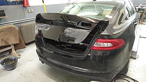

Hi guys,
I own a 2009 Jaguar which I bought half a year ago and I just found out there's rust on my trunk. It's just above and below the chrome part and probably under it.
Expert said this happens due to this chrome part rattling against the paint for all those years...
Does anyone else have the same problem?

This is the problem...
The parts holding the screws slowly snapped off on sides and then the whole crome stip started hitting the trunk paint. That's where the rust was from.
The mounts for screws failed because of pressure from lifting the trunk up holding the chrome strip everytime. Black thing is used to glue it back.
Solution, new paint and a small spacer on the screws ( visible on the picture ).
