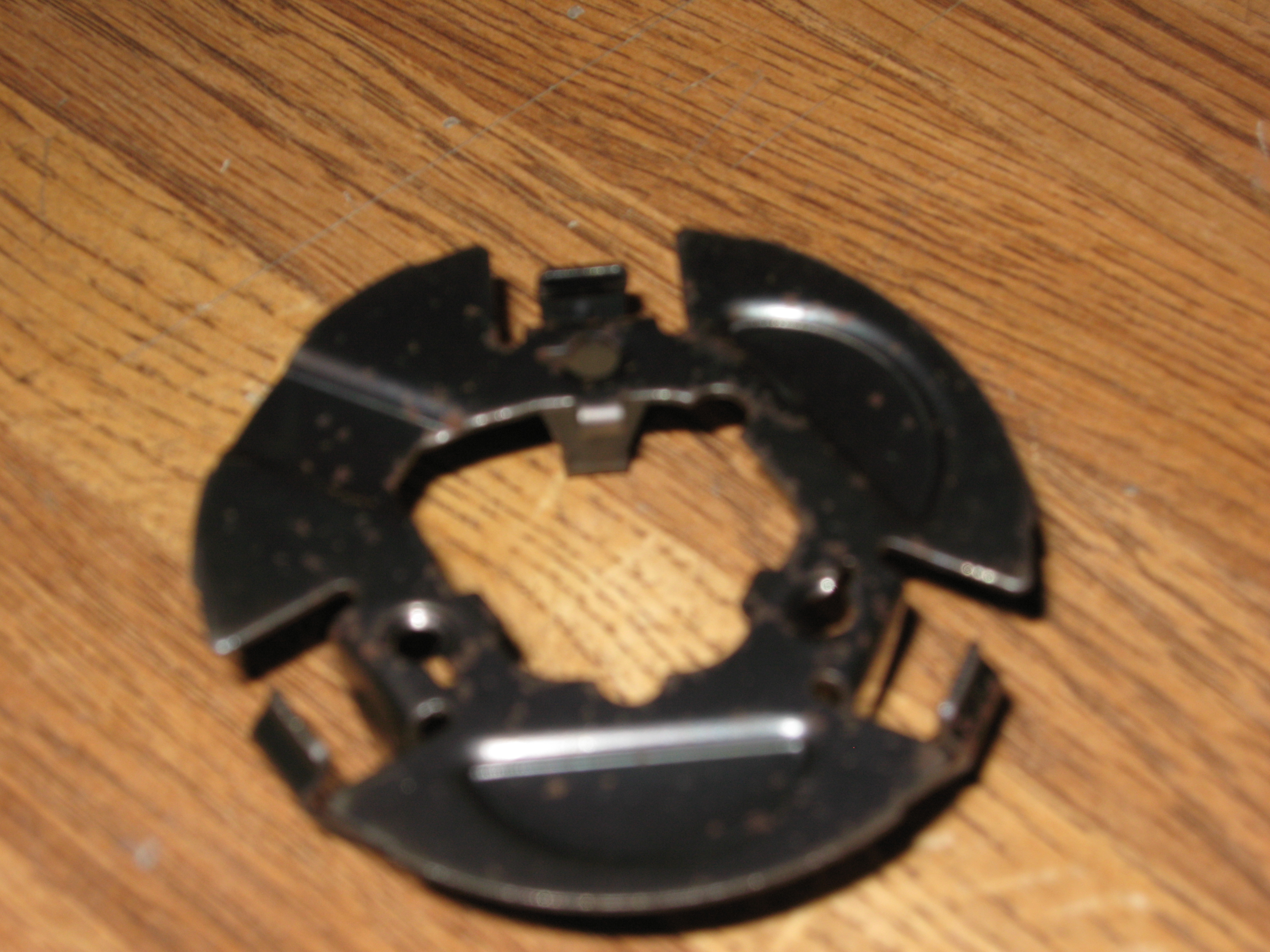

I went to the Jaguar dealer parts department to see what their parts diagram showed for sun visor related parts. Underneath the plastic trim, there is a retaining clip (part no. C2Z11347) which seems to hold the outboard edge of the sun visor in place. Since it was only $8, I thought I'd take a gamble and order one. Attached is a photo of the part. When I get a chance, I'll remove the trim piece and see if replacing the retaining clip eliminates the problem.

Please let us know if that part fixes the issue.
