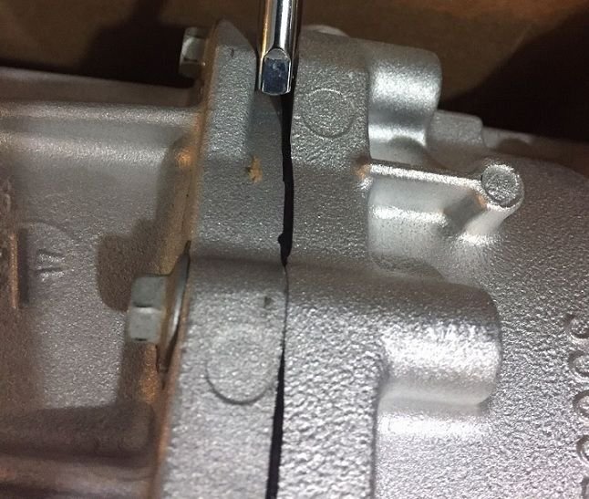

Not much help but as you found out that sealant is tough. Be sure and use the proper sealant when replacing the snout too. Not just silicone. Don't know why they want it glued on so tight but it's what Jaguar recommends. Loctite 515 a bit hard to find.
Jaguar did gave us a spot to pry the SC snout off too. Some people say it's still hard to separate them.

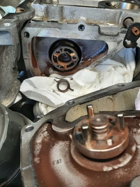

I found the pry spot and with relative ease a crowbar got it off. Now for the coupler - part of the spring came out but part of it is still in there - I either broke it or it comes in 2 parts.

The spring can and does break from use. Yours looks pretty bad with the damage done to the shaft. Pretty deep grooves?
Don't know if the grooves will cause any problems but that's why I got another complete snout from Jaguar.
Are you going with a solid coupler? We have had a long discussion about the pro's and apparently cons too of the solid spacer.

I think I have to go with a solid coupler - the deeps scores left in the shaft (from the spring I assume) makes me think fitting a spring coupler will give me problems. From all the discussion I have seen it seems hit and miss for people having issues with a solid coupler so fingers crossed I don't have nasty noises when its all back together. There are shops here in the US that recondition snouts and will do an exchange - that's plan B.
