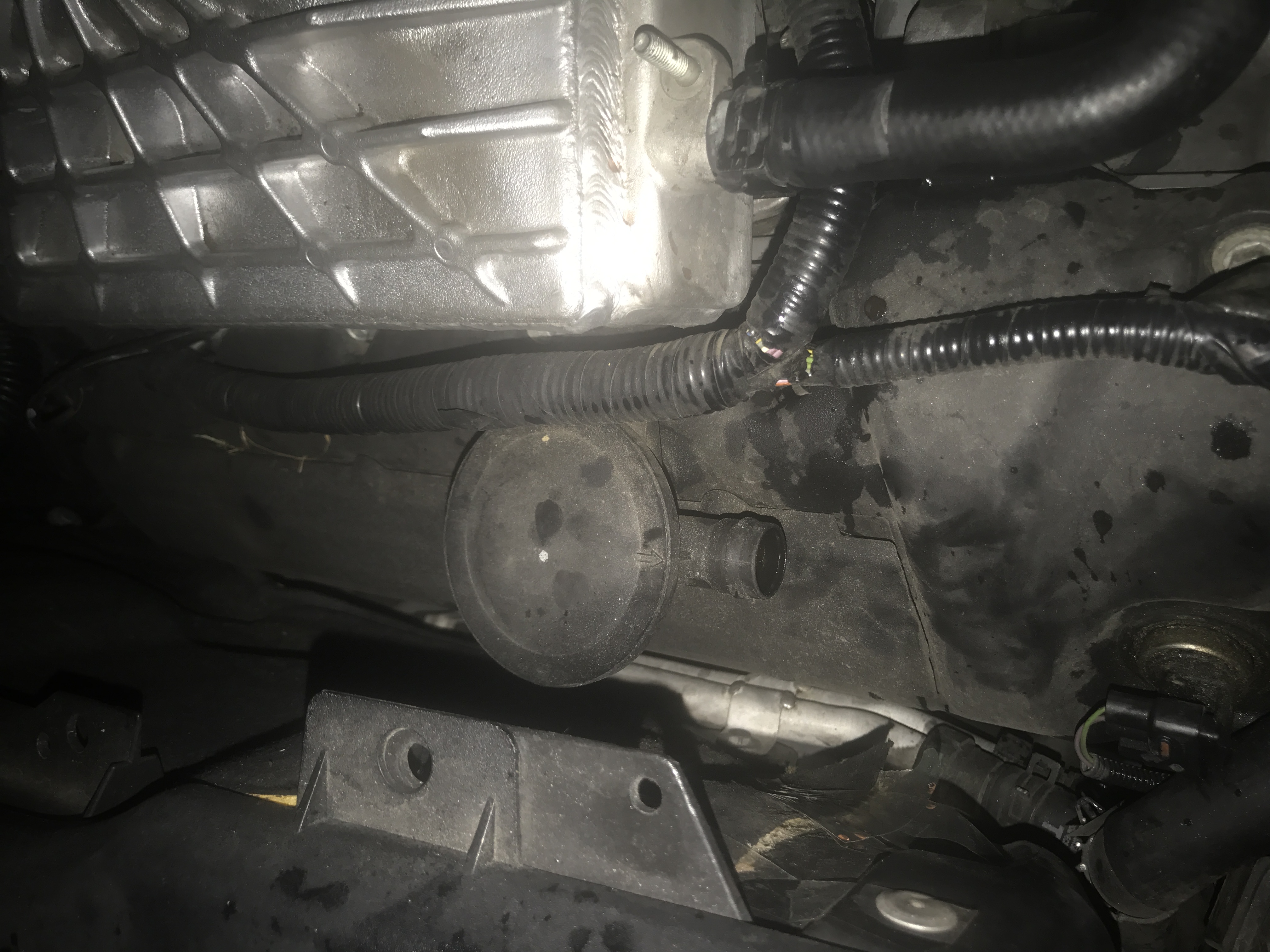

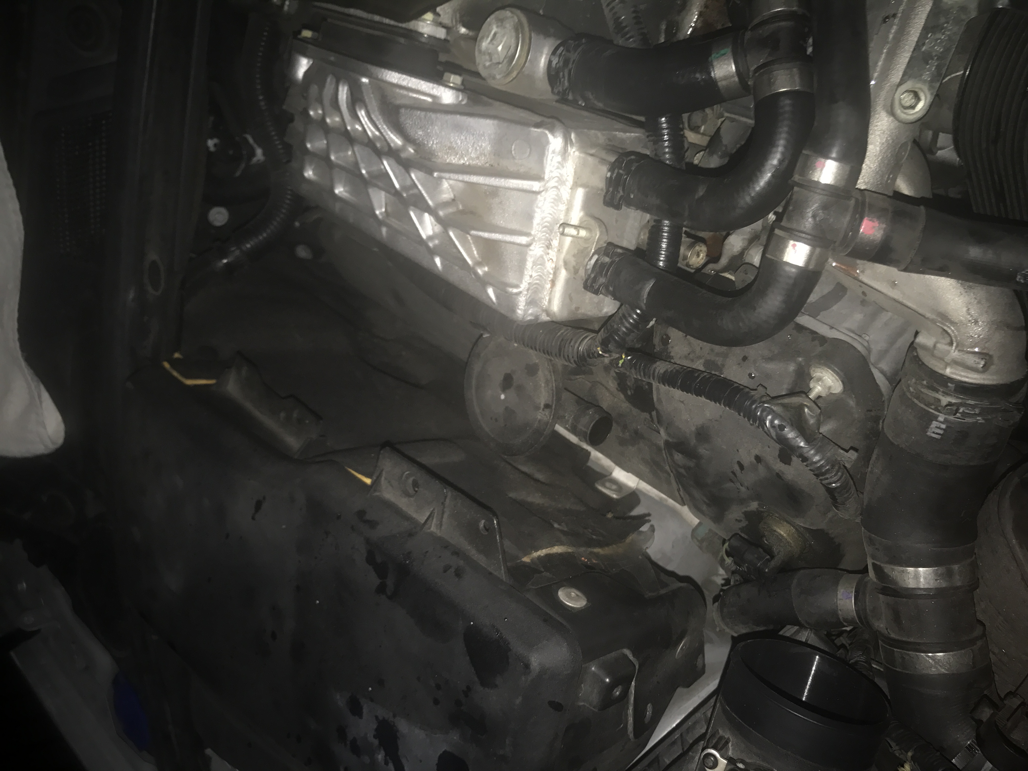

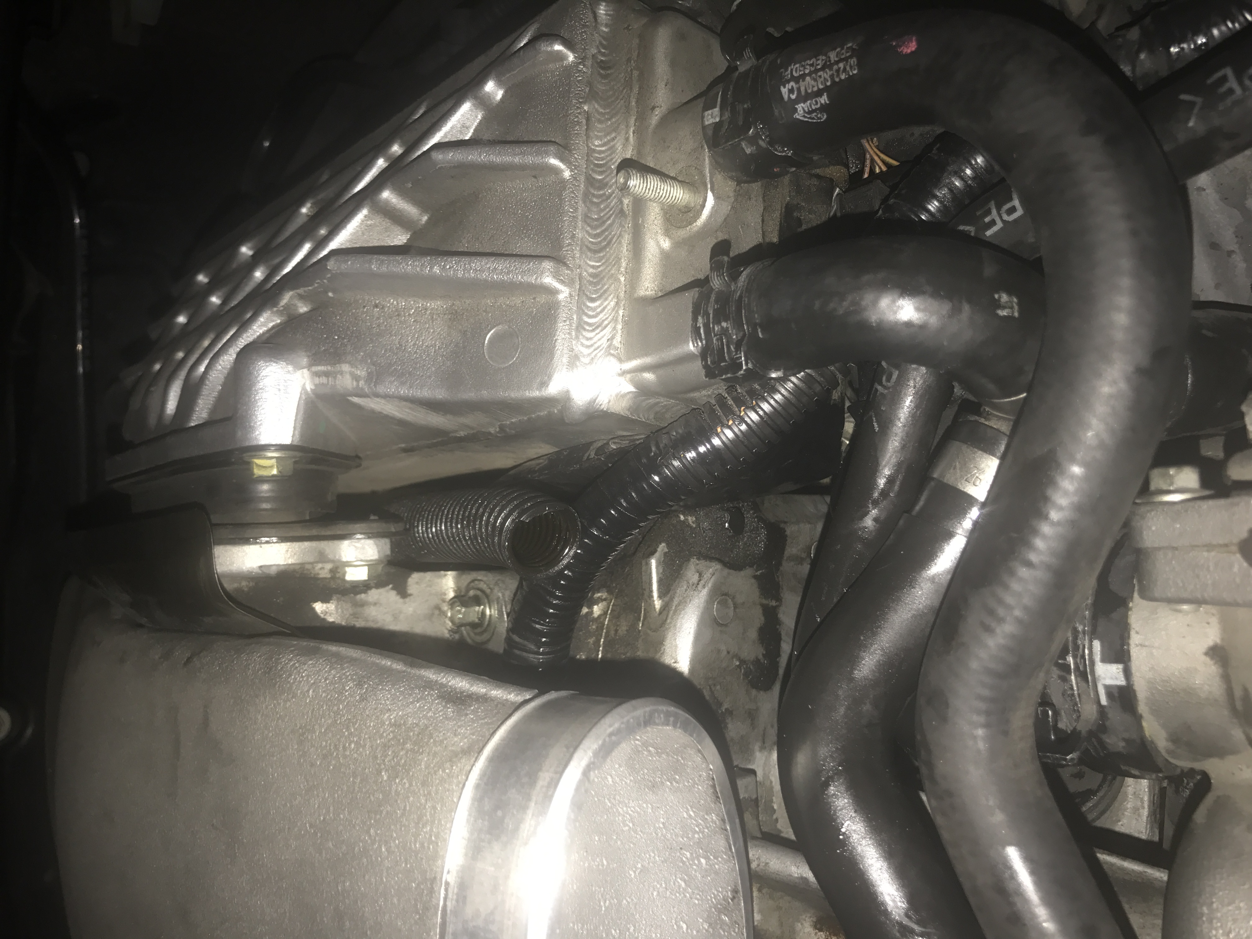

Hi I was trying to change the super charger fluid when this black piping broke. The heat made it very brittle.
I have attached a few pics, it was attached to this black thing.
My question is, what is the function of this thing and what is it called?
Thank you for the help

It appears that one of the hoses, that is part of the crankcase ventilation system, is missing.

yes that was the hose that cracked because it was so brittle. Is it a required part to drive the jaguar? I haven't turned it on since. Or is it something just needed for emissions?

I posted my "half reply" early this morning, before I had a chance to go out in the garage, and take a look under the hood of our XF. Our car is a non-supercharged, '09. The hose on our car, runs between that "canister" that's in your picture, on one end, and feeds into the throttle body, behind the throttle blade, at the other end. I'm sure that the other end is probably obvious to you.
I know that Jag used the fancy "press-to-release" clamps on each end of the hose, but I reckon that a simple piece of automotive grade, rubber hose would probably work, too. Without this hose in place, I assume you'd have a massive vacuum leak.
Good luck!

thank you so much!! I'm going to try to find a replacement hose for this

It's part of the PCV system. Get the hose from the dealer. A normal rubber hose won't work.

Well, a normal hose would work it you routed it correctly and had clamps on the ends. Without the hose there would be a massive vacuum leak. The car likely wouldn't run. If it did run it would run poorly and stall.
Although the OE "hose" is all nice and molded to shape, and compact, in a pinch, in order to get the car running, a piece of heavy duty, automotive rated hose, would work just fine. Before engine compartments got all compacted and cluttered, requiring "molded to shape" hoses, Chrysler, Ford, and GM, all used simple lengths of rubber hose, for their PCV systems......for MANY years.

no I'm afraid a normal piece of hose will not work . the PCV PIPE we are talking about holds 30hg vacuum on deceleration . In which will collapse a pubber pipe .
however i have repaired one of the plastic PCV PIPES before with a piece of 16mm ID hydraulic vacuum return pipe . IT SLIPS over the stock plastic pipe snugly .
it will join two pieces of plastic PCV pipe perfectly . without trouble .
in fact my repaired pipe is still functioning 2 years later , and the hydraulic hose will likely out last my car .
the old chrysler . ford , gm cars mentioned before were only crank case pressure relief to the air cleaner box . not out right manifold vacuum to under the T/B like modern cars . quite a different set up .
