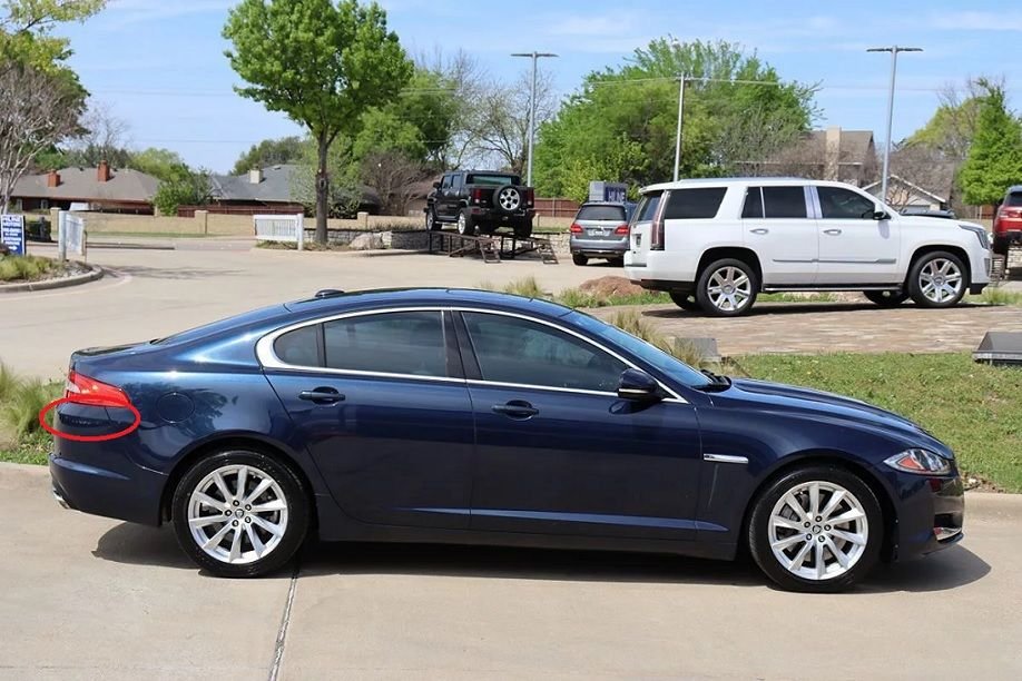

I can see some imperfections on the front bumper cover and depending on the photo- does not the paint look funny on the hood (bonnet)? Someone has been rough with the start button, but there are some nice stick-on upgraded looks for that and with the big key hanging around the trim near the tranny switch- you can see some rough edges. Easy enough to find at the used part guy in Irving (TX). Does appear t have the sticky button issue, but I believe I read that makeup remover will solve that.

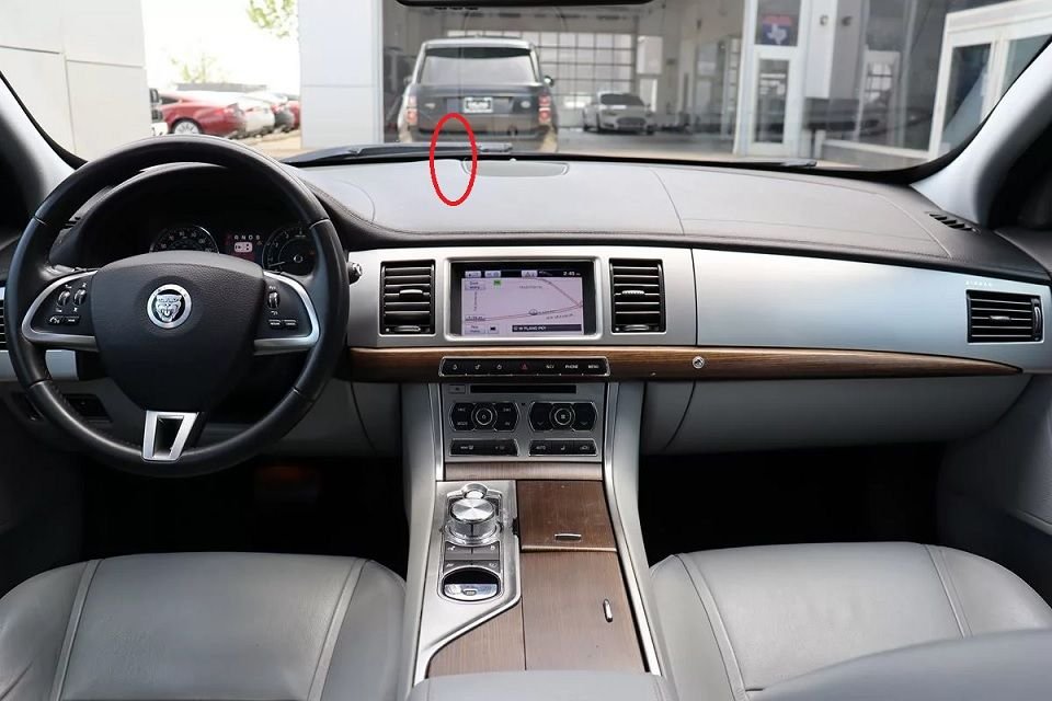

I agree with doing a PPI. The only thing that I see in the pictures is that the dash looks like its messed up around the center speaker. I think its just the base stereo system and the leather has pulled loose around the center speaker that makes it look raised up. This is Texas and it would only take one summer parked outdoors in the sun to ruin an XF dash. It is the color I wanted when I bought mine, but I noted that this one is not a Portfolio edition, but rather a base model. If you need lumbar support, this one doesn't have it (that was critical when I bought mine).

I noticed that raised part as well, but want to see up close and personal. They are not but about 10 minutes from me.

I do see a bit of raising on the leather dash too? What does it look like in person? As you know the leather dash problem is a big one for any XF. That center speaker grill will be crispy by now so plan to change it. The grill is not expensive.
This might just be cosmetic and you already mentioned the worn starter button but all the wear around the shifter would bother me and I would plan on getting a new piece. But up to you. Kinda weird wear but maybe he drove with his hand resting on the shifter/console?

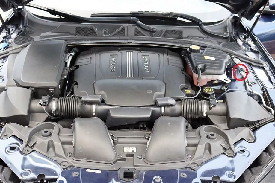

I do see a missing AC cap under hood? Has any AC work been done?
Water pump replaced?
Scuffs in paint and head light lens on front passenger side.

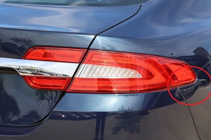

Some more scuffing around the rear passenger tail light but it's hard to see so I maybe I am wrong?
Sorta see it on the tail light picture too.
