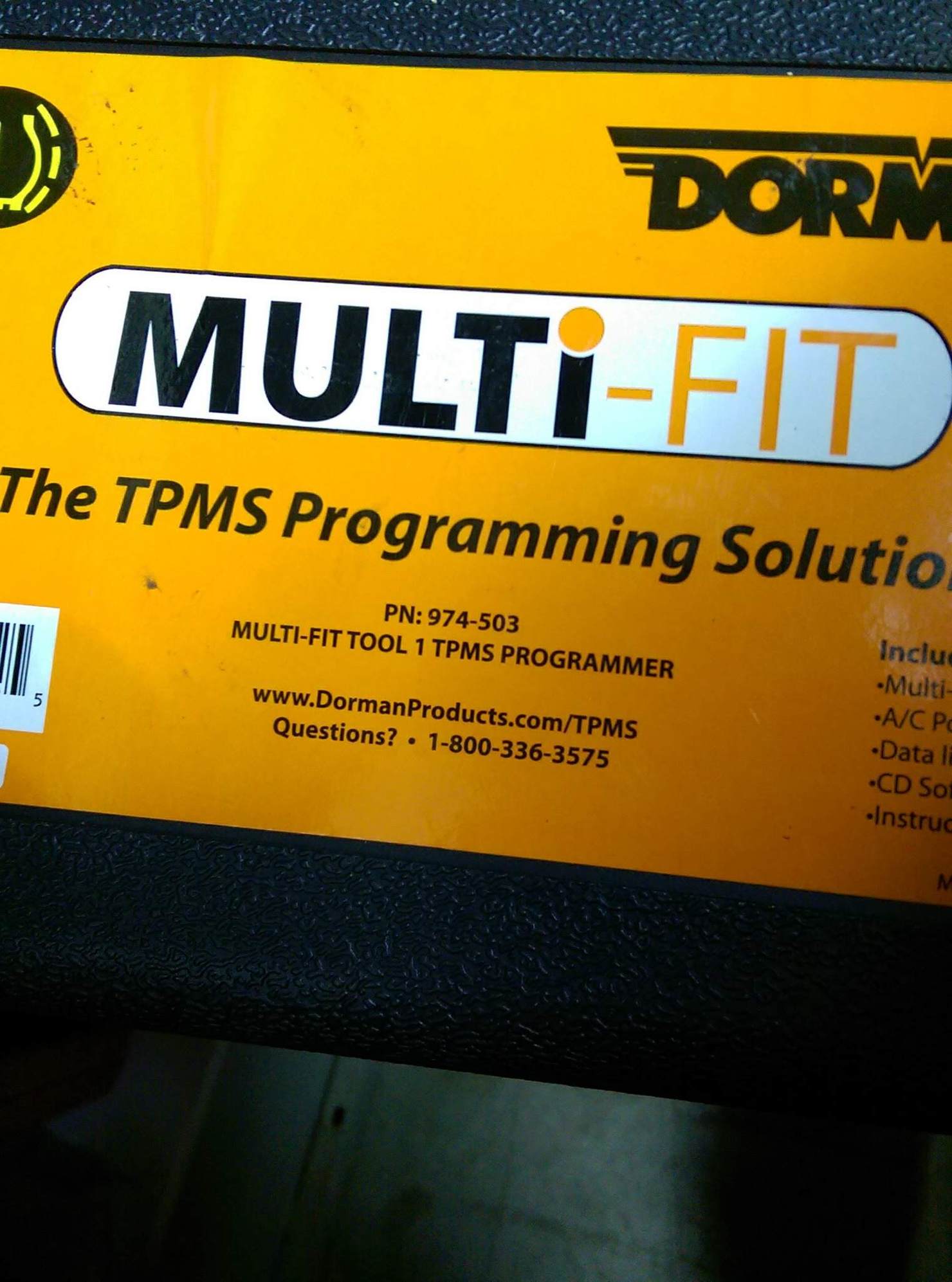

Do you remember the Doorman's part number of the sensor and tools you had? Or the sensors?
I was looking on their site and it looks like the sensors they have is only up to 2011 XF... !? Wouldn't previous years to 2012 years use similar stuff?
https://www.dormanproducts.com/p-283...tor%2520Sensor
And found their tool - locally seems to be going for around $300 CAD
Old Apr 14, 2019 | 05:22 AM
Bigg Will's Avatar
Joined: Nov 2014
Posts: 1,592
Likes: 369
From: SO, CaLi
Originally Posted by mrNewt
Too bad .
The broadcast frequency changed looks like in 2012. My post was from last November so it's the same sensor number you linked to. The tool and sensors.
