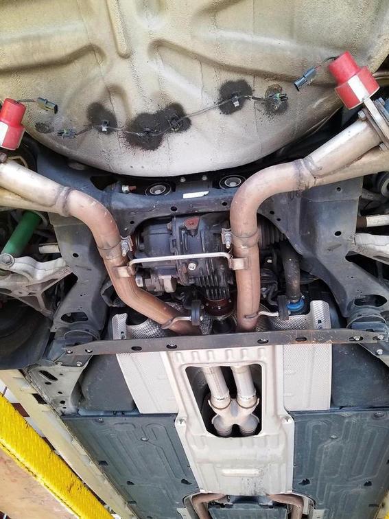

@Reaxions If you're able to get a good photo of your x pipe during your project please post it up!

Just seeing this... You still need the pix? I can go out now and get some, if you want. If you PM me, I'll give you my email/phone, so you won't have to wait on me to notice new replies, next time.

That would be great Jeff, thanks!

Here's a really old pic, from before I installed the Mina rear cans...
