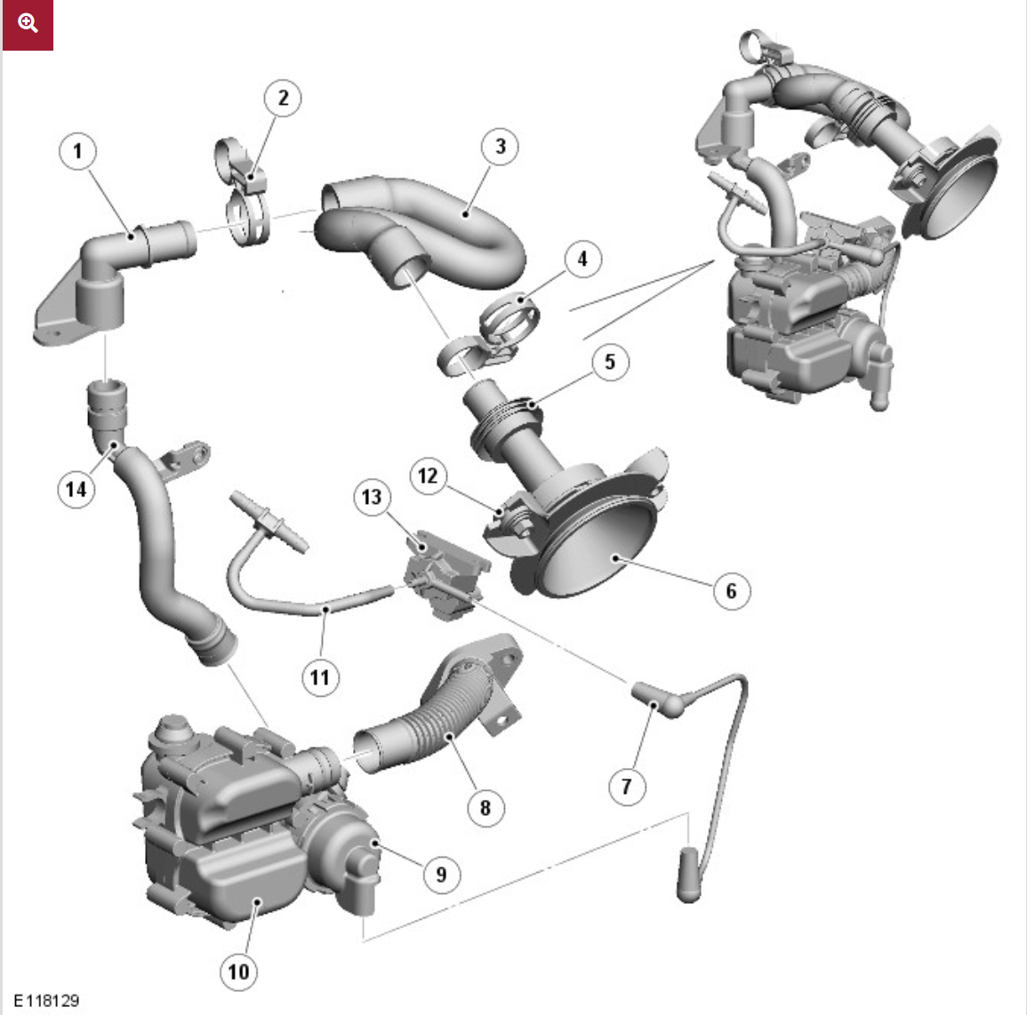

As part of a much larger project I'm deleting the Musical Instrument from the engine compartment and have a couple lingering questions that have me hesitating to close my eyes and hope for the best. I've installed the V-AP plate to make the air cooler whole and have the Symposer by the throat and safely away from the car where it can do no further harm.
Q1: The Tuning Valve (cf. part 13 in the diagram below) has a Tee into the brake vac line (part 11), which sounds important. Should I: (a) leave the Tuning Valve in place, unpowered; (b) leave it in place, powered; (a-b.1) if either of the former, cap the tube that connects to part 7, or (a-b.2) leave it open; (c) remove the Tuning Valve and effectively delete the tee; or (d) something else? What is the best practice for someone who does not intend the deletion to be reversible?

When I removed the Symposer I simply capped the vacuum port and left the electrical plug in place. No problems and no errors unless you dig deep into SDD.
