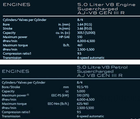

Old Nov 30, 2017 | 05:47 PM
u102768's Avatar
Joined: Jan 2010
Posts: 2,941
Likes: 1,511
From: New Zealand
Originally Posted by OzXFR
And it's not 510 bhp, it's 510 PS or 503 bhp. XFR spec that is.
The car magazines get that wrong 99% of the time, so the myth perpetuates that the XFR has 510 bhp when it does not.
I don't think that Jaguar help the situation because they quote 510 HP-SAE in US brochures but 510 EEC-PS in UK brochures.
Old Nov 30, 2017 | 06:53 PM
BritCars's Avatar
Joined: May 2012
Posts: 2,557
Likes: 503
From: Boston, MA USA
If I remember correctly HP and PS (in Europe) are only about 1% different. So I suspect they prefer to pick a number for consistency rather than two almost identical numbers in the two locations. Prob helps to avoid confusion.
