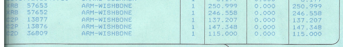

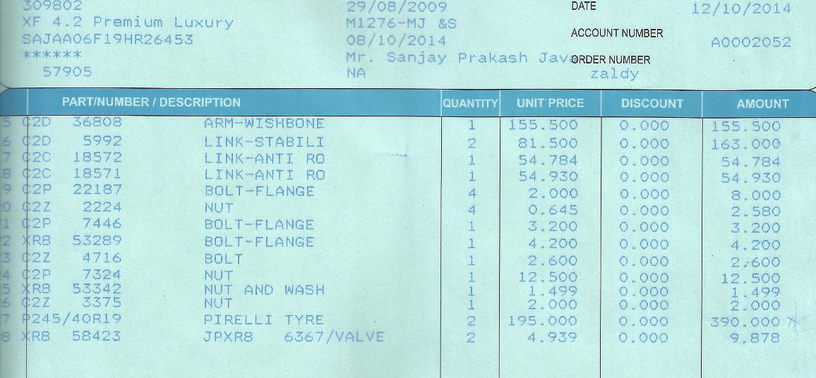

Now I got the estimate from the authorized dealer
To see in US$ multiply by 2.65 please
I hope this clarifies what have to be done (if you follow the dealers opinion)
Labour cost is not included (don't ask my why, I will need to ask again for the labour cost ...)
Oh wow, that's outrageous. They are basically saying that all the wishbones need replacing, plus the anti-roll bar links.
