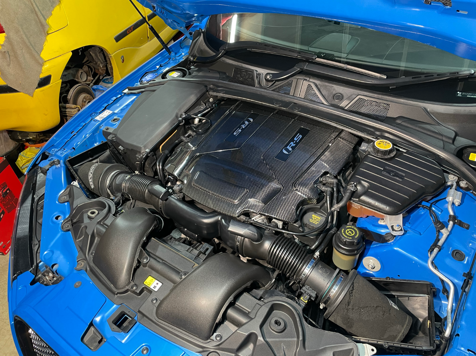

Default Working on this jaguar intake system for my car full carbon intake

Originally Posted by no1
you should add a couple photos I'm curious to see how it fits and looks. With my 2013 xfr I would only be able to get away that type of setup on one side, the opposite side has some type of an intercooler that is smack dab right in the way
Most definitely will be posting more pictures. I made it work with the existing plumbing. It work around it for me . I would have to see your set up . I wanted my stock intake scoops to also continue to function as well without removing or relocating anything
