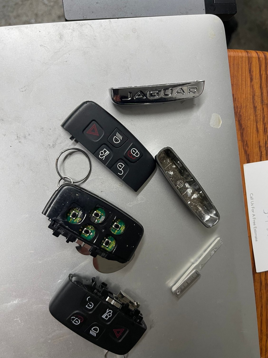

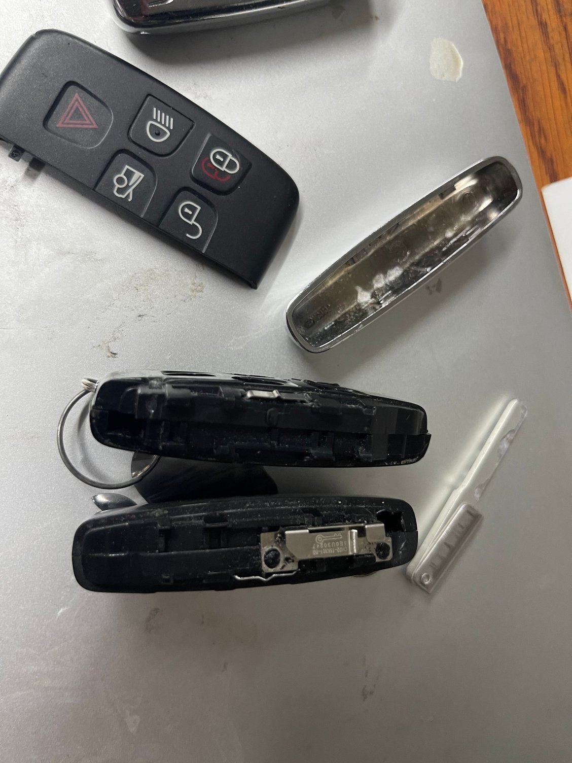

13 xf dead, 39k on it, trying to find where i can jump it from front. I tried opening the trunk but the key is pretty much plastic and doesnt have much leverage.
do these look broken? I was gonna change the batteries first

Yes you can replace the key FOB housing. They are all over EBay. Just make sure to match your old one exactly.
Not very expensive either.

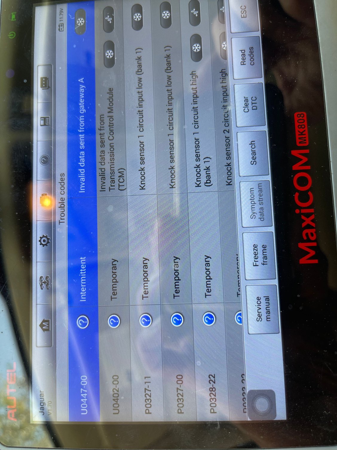

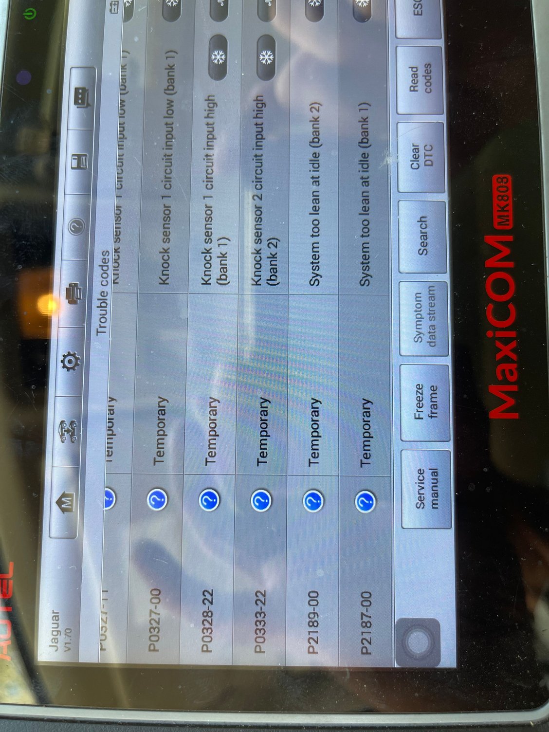

Unlocked it. Motor does not sound good, dang at 35k. I tried to load the video but it just says upload and nothing happens. Here are some codes

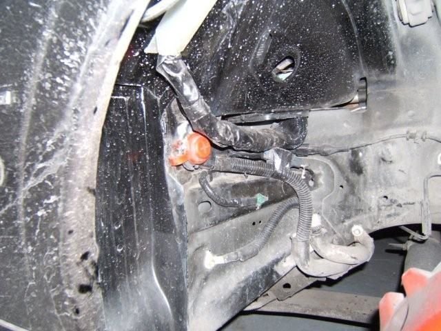

They do have a jumping spot up front under the hood? The attached is how Jaguar recommends to open the trunk. It's in your owners manual.
The car also has a separate positive terminal that is behind the front passenger side plastic wheel liner. Does not seem to be talked about much either?
Note this picture is from an Lincoln LS.
That's a lot of codes for sure!
