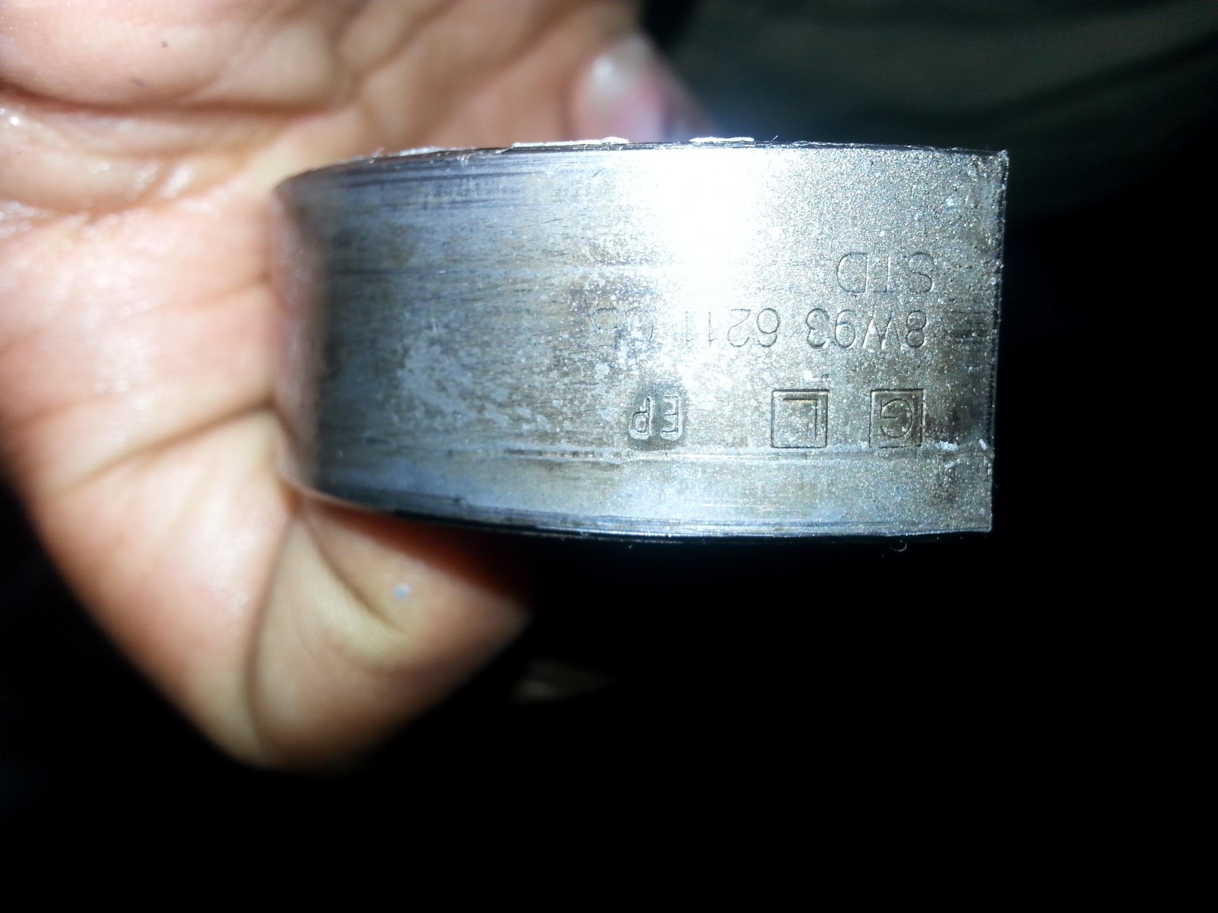

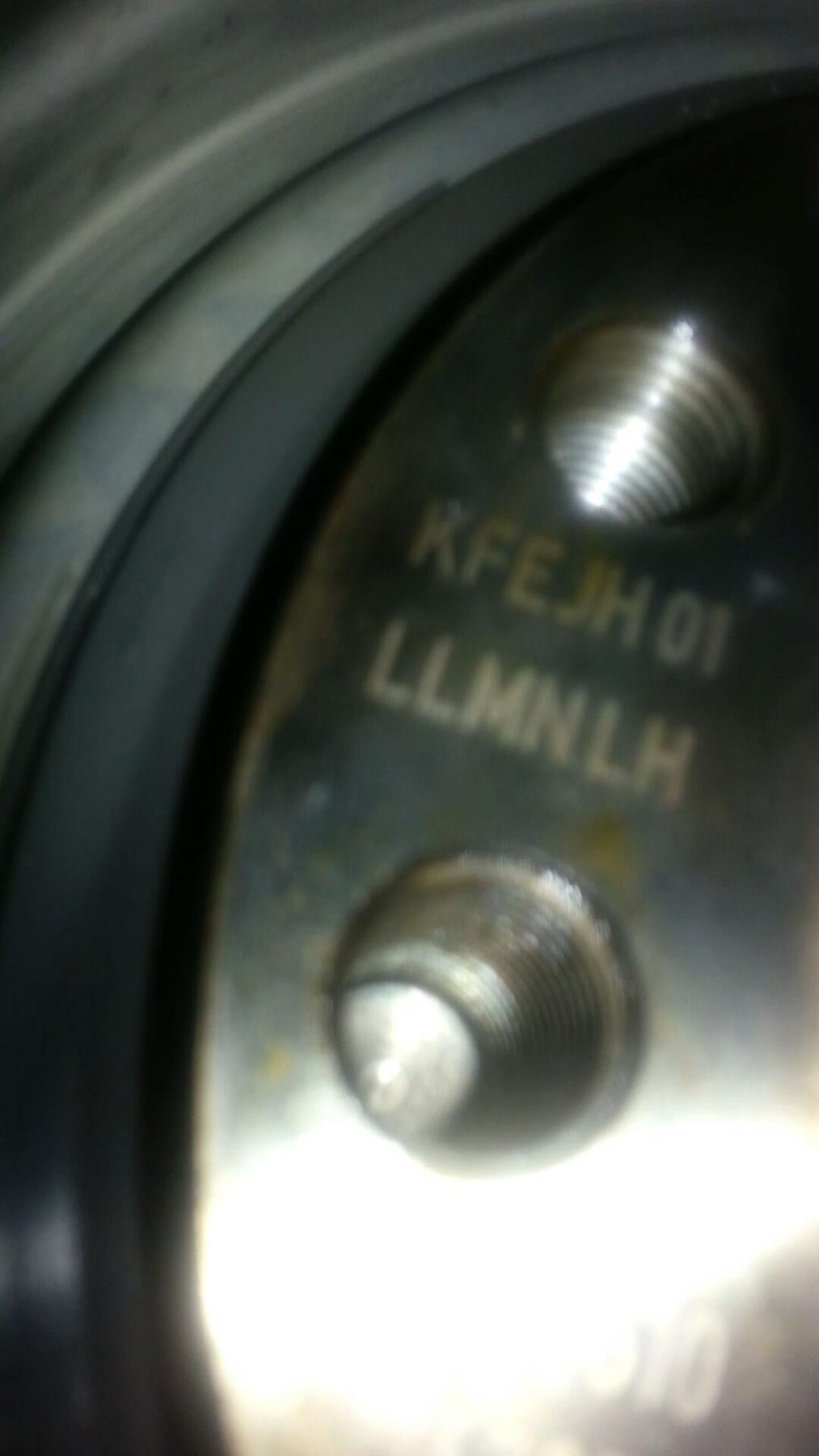

I want to replace the bearings in this engine but dont have know the bearing sizes, I have the size codes from the back of the crankshaft but dont have the chart to know what each letter means.

If you are not regrinding then logic says get the same bearings. If you are doing a regrind get the shop doing it for you to obtain the bearings.

I have the October 2013 parts list and there are no bearings, pistons, rods, etc. listed for the 5.0L, either they are simply not available as spares, or they are under-the-counter items that only certain people can procure...
Old Apr 9, 2015 | 02:46 PM
Fraser Mitchell's Avatar
Posts: 9,556
Likes: 2,555
From: Crewe, England
This kind of stuff is normally supplied to the "trade" and only they get the parts lists and prices. So an approach to an engine builder may get results. As this is basically a Ford engine, there may be commonality with other Ford engines

I have struggled the same way you guys do and found a good supplier for these bearings
Landroverbh@gmail.com having them..
also having oversized shells
Cheers..

8w93-6211-cb
8w93-6333-aa
I have the same issue on my 2012 LR4 I'm working on rebuilt the bottom end of the engine
