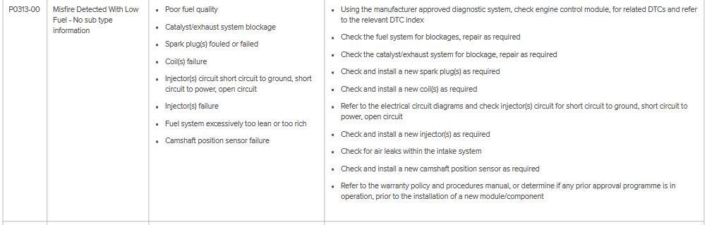

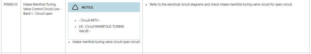

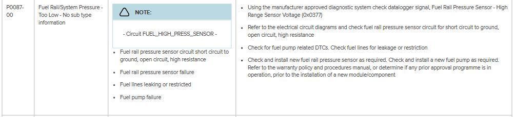

Low fuel pressure can also be caused by a leak in the fuel lines, little or no fuel in the tank, a clogged fuel filter, a crimped fuel line, etc.
Fuel-related misfires can be caused by fuel contaminated by water, which is surprisingly common.
Here are the definitions and published possible causes of the codes we know of so far (not including the cylinder misfire codes). The strong fuel odor and definition of P0087 are what prompted me to suggest that a fuel leak be ruled out. The P001D-13 and P0313-00 DTCs also suggest a problem with a cam solenoid or sensor or their wiring.
Before we try to help much more, are there any other codes stored? It helps to see the complete picture.

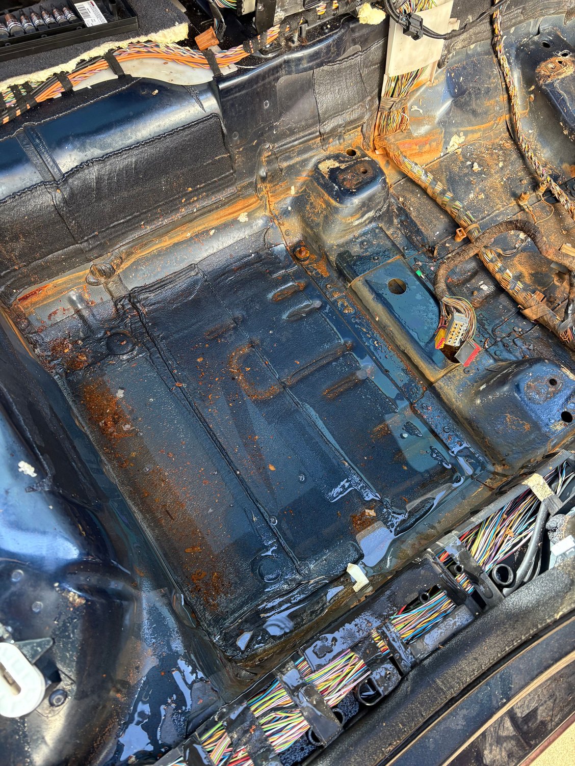

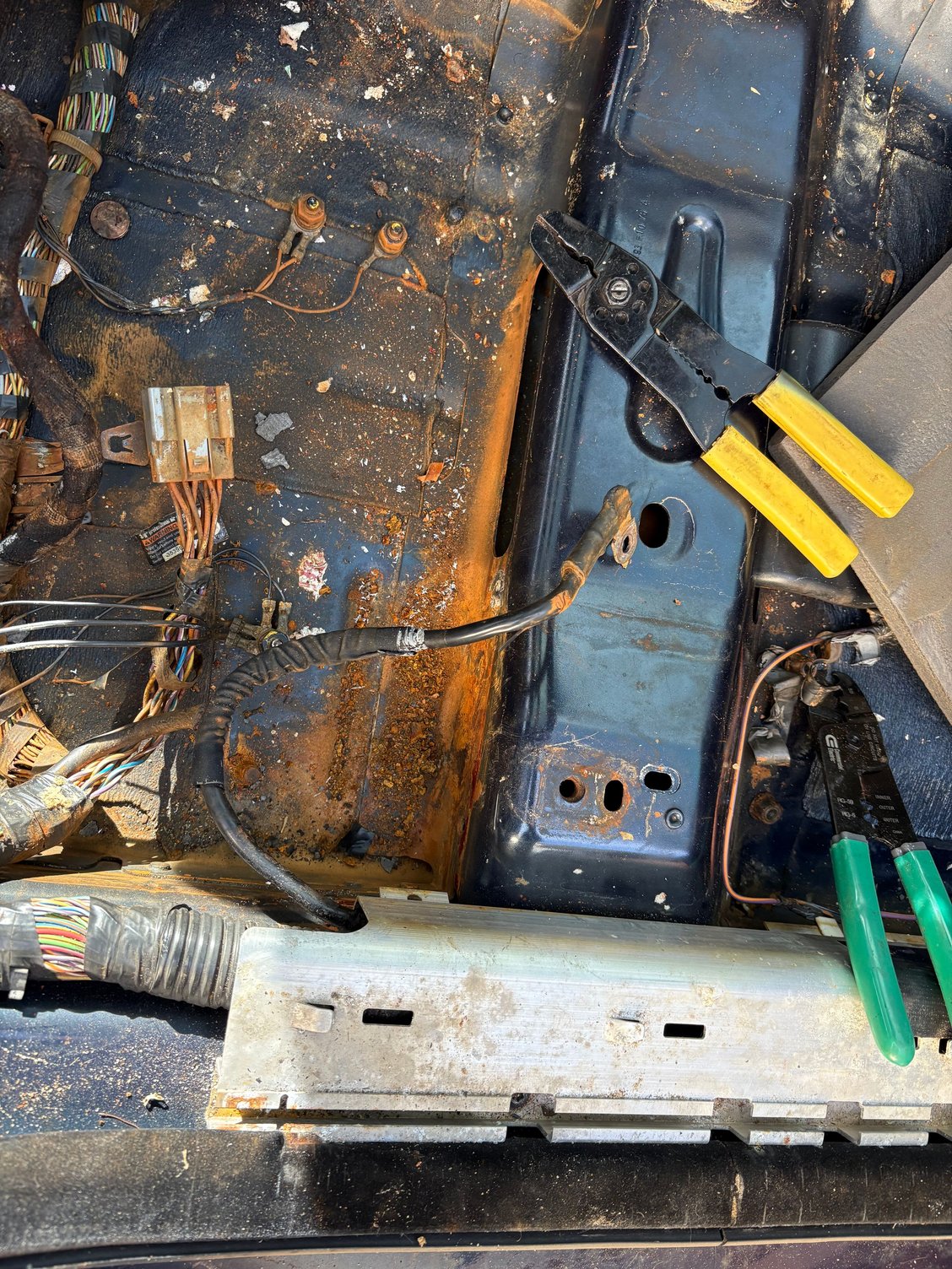

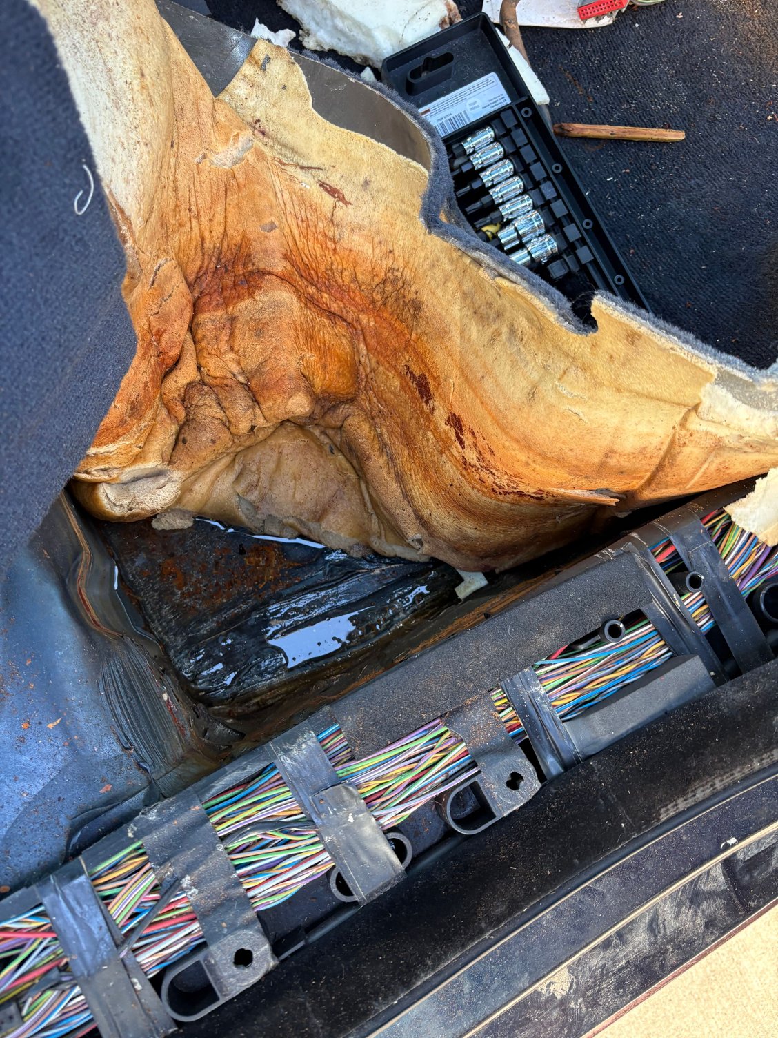

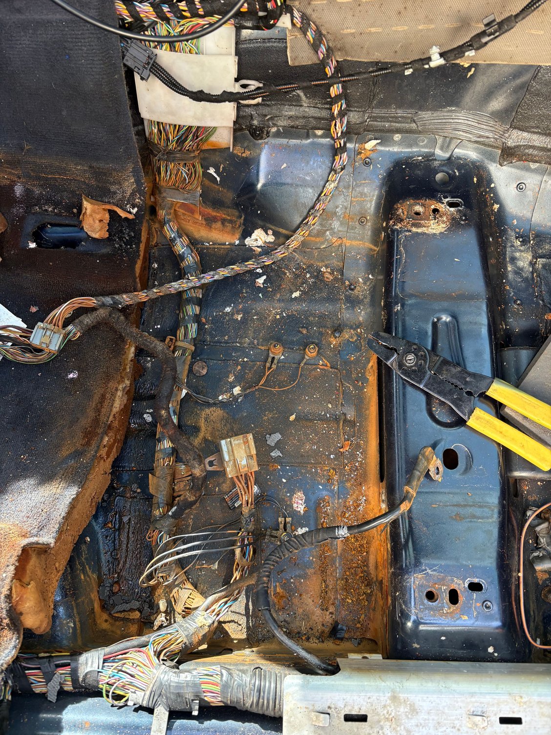

Old Jan 1, 2026 | 03:07 PM
Durvelle27's Avatar
Joined: Dec 2025
Posts: 54
Likes: 8
From: TN
Alright I know it’s been a few days but here’s an update. I’m actually no longer thinking this issue is clogged injectors or sticking injectors. I’m starting to think it’s electrical related. I drove the car and the battery light kept coming on and it drove worse and worse. Battery is a brand new AGM battery and alternator.
ripped all the carpet out and this is what I found on the passenger side under the seat
I also found this under the passenger seat. Looks like a inline fuse that was installed between the ground from the rear to the front

Man that looks like a flood car?
Old Jan 2, 2026 | 09:28 AM
RoverJoe's Avatar
Community Influencer
Joined: Oct 2025
Posts: 496
Likes: 183
From: South Florida
Might want to consider replacing the body harness as a starting point. Have had to do that on an XJ with severe water damage. Once you get rust/corrosion in some of the electrical connectors, it ends up in all of them.
Is this a car you need to keep? I would bail on it and find one without water damage, as a technician.
Old Jan 2, 2026 | 09:52 AM
Durvelle27's Avatar
Joined: Dec 2025
Posts: 54
Likes: 8
From: TN
Don’t get floods here. Was a dang leak that I still haven’t found. I thought it was the cabin filter but I fixed that. Now I’m thinking the sunroof or windshield
I was definitely looking to replace the interior harness. Only the passenger side is affected. Everything else is clean. Instead of replacing the entire harness I was thinking of cutting out all the corroded wires and splicing/soldering in new wires in the affected area and replacing the whole main ground as it’s corroded badly.
honestly I’m debating on it. These cars are super hard to find here where I live. I’ve literally never seen another I. Person outside of the donor I’m using to fix it.
