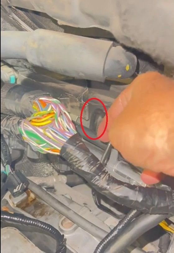

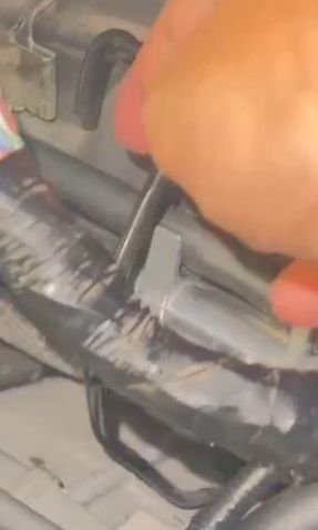

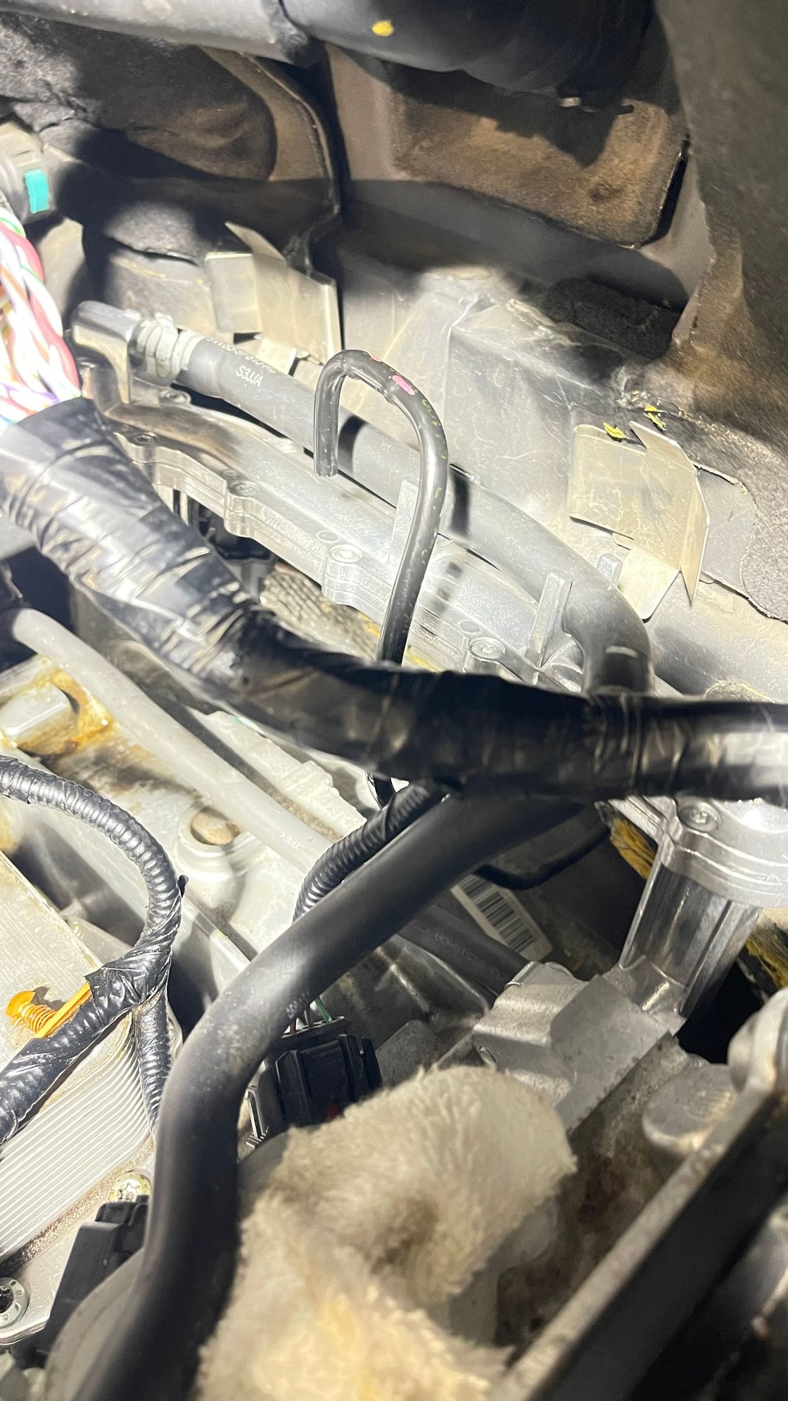

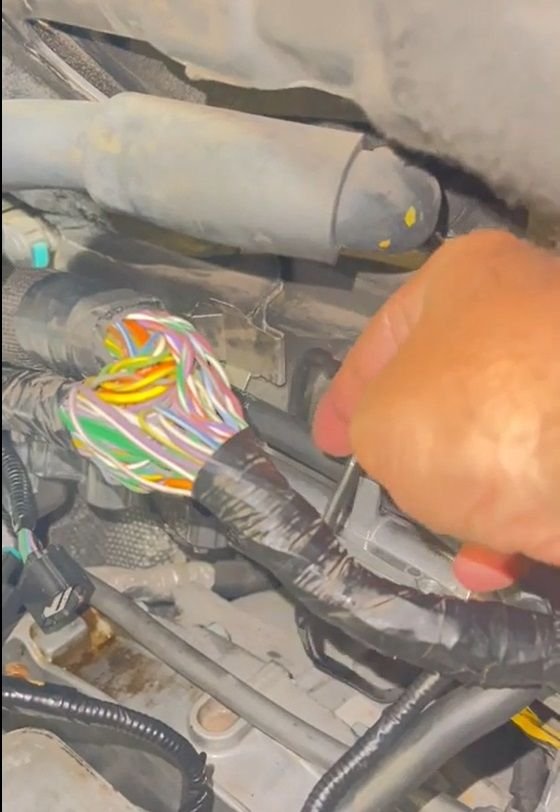

I need some help to jog my memory. I have been taking my time to do a coolant pipe upgrade because of leaking Y-pipes. I am also exchanging the rear crossover. As I begin to assemble the items in the rear of the engine I noticed a small tube (in my hand in the picture) that traverses down the back of the engine and exits to the bottom rear of the engine bay. It sits at the level of the symposer at the top, but the tube connections to the symposer seem fixed, ie - one pipe/tube connects the top of the symposer to the bottom of the symposer. Anyhow, can anyone point me in the right direction as to the connection point for this tube? I am drawing a blank as I reviewed the symposer and the super charger (top and bottom) and I could not locate a suitable home. Please help! I'm hoping to get moving on making the final repairs, but I am stuck on this one.

Is it the metal vent pipe from the transmission?

Your pictures are confusing so this maybe wrong? But I think RoverJoe is right.
The small plastic tube I have circled is a vent for the transmission and is open ended. So it does not attach to anything.

It is plastic. It is entirely possible that this was behind the coolant crossover pipe / plastic cable wire loom and that it was unconnected, and I just didn't see it. I was hoping someone had a diagram they could convince me with as I don't want to button everything up and have this be a source of problems.

It is the transmission vent line, and they are plastic, not metal.

As I posted above and as 12jagmark posted above. It's a plastic vent tube for the transmission.
Here is the thread where we figured it all out. With MUCH better pictures.
Transmission Vent Tube

Sorry I was thinking the newer ones where they went to metal lines, but yes that's the breather tube.
