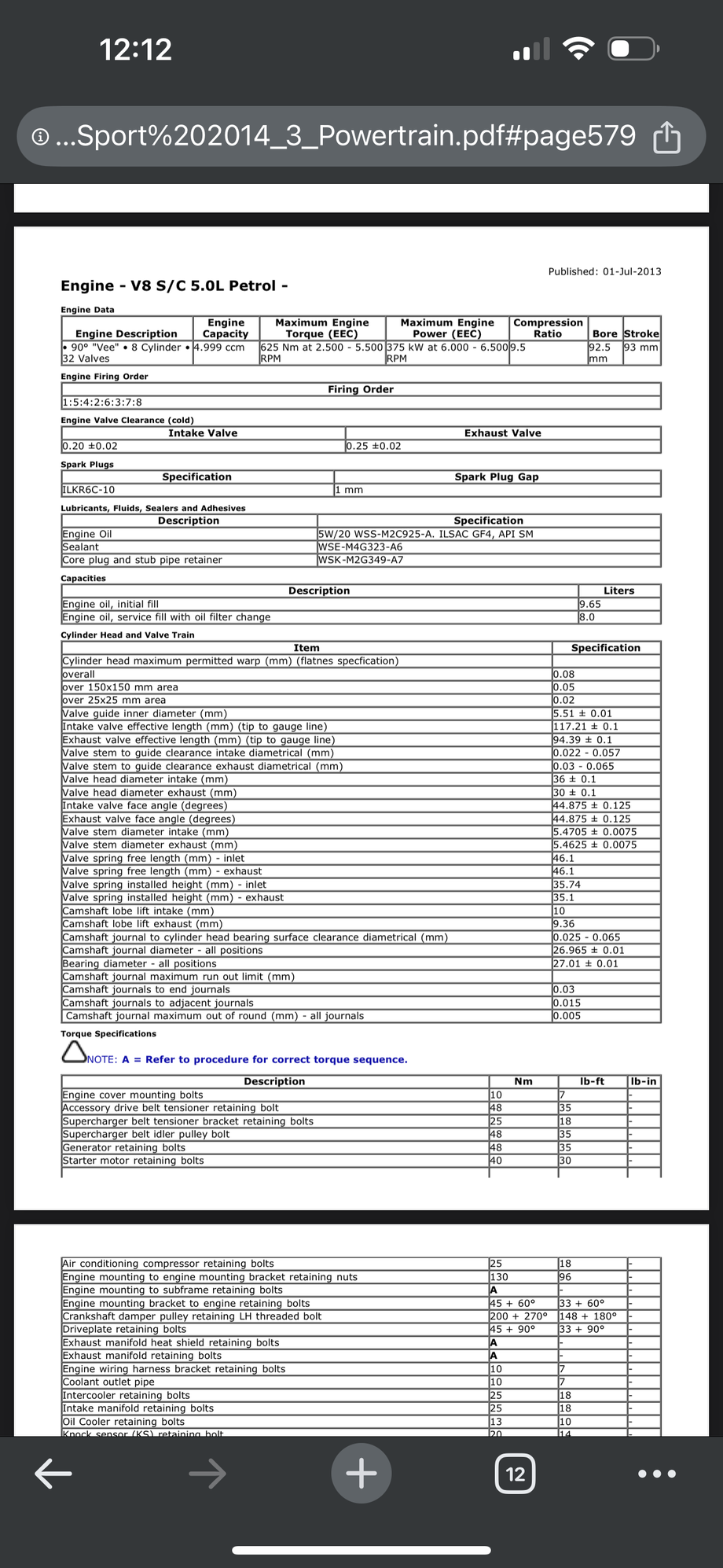

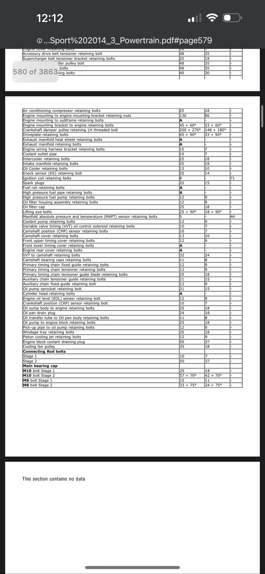

Hello. Would anyone know if the torque specs I posted below for the 5.0 s/c engine, also apply for the 3.0 s/c engine? Mine is awd if it matters (probably doesn’t). The torque specs I’m looking for on the 3.0 s/c are the main bearing cap bolts for the M8 and M10 Bolts. And the Conrod Bolts as well. Any suggestions are appreciated!
edit* Also wanted to ask if it’s possible to reuse the Main cap Bolts and ConRod Bolts? Having a really hard time finding them online. Ha! This engine is far from being rebuild friendly!

Here ya go.
From the Workshop Manual for my 2014 F-Type V6.

Originally Posted by OzXFR
Here ya go.
thanks! Appreciate it!
just to make sure it’s the “Balance Shaft Assembly Retaining Bolts,” Right? And that includes the M8 and M10 Bolts?

What I read is pretty plain and they call them connecting rod bolts?
Go all the way to the end of what OzXFR posted.
For the main bolts I don't know. The list is not that specific.
I appreciate it! Yeah the rod bolts are easy to find. It’s the mains I was concerned about. Thought maybe someone here might know if the 5.0 would be exactly the same since only the 5.0 Manuel has that info. Very strange to leave such crucial info out for the 3.0.

I would guess that the Mains are listed as the balance shaft in the list provided OzXFR. Isn't the rear balance weight the journal without attaching rods?
The numbers look close, and nothing else in the list seems appropriate.
yeah the rear balance weight is the journal without rods, you’re correct. I will look more into the similarities between the two engines. If I find nothing elsewhere, I’ll probably just use the v8 specs.
