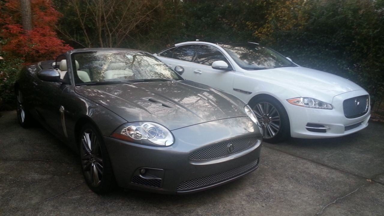

Is your Public Profile correct? It shows a 1995 Sovereign 4.0. Did you just buy the 2013 XJL? If not, and massaging seats are a must, then I suggest you keep looking nationwide for THE ONE that floats your boat. Otherwise, the cost of adding massaging seats will put you so far underwater that you'd wish you bought a submarine.
Owning two Jaguars is great fun, not aggravation. You just don't have the right two Jags.
