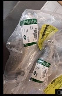

I noted on another forum JagInfo.org that they had identified aluminum cooling pipes for Land Rovers, v6 supercharged. But no info for fitment on Jaguar. The Y-pipe and the front cross-over LR186859 and LR186917. Included the following image:
Recently available from Land Rover
When I searched a dealer's web, they do not supposedly fit a 2016 Supercharged Range Rover. Is that the best Land Rover match for a 2016 AJ126?

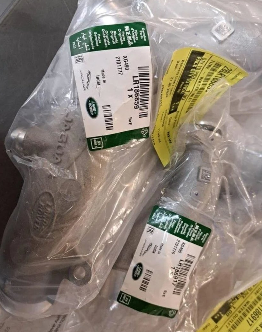

Sorry, here is a better pic
Made in India, not China.

When I read the JagInfo thread, JohnRS clearly says he has a 2016 XF X260 with the 3L SC, and the picture is a match to my 2016 XJL AJ126.
I think it is worth the gamble.
I see a previous thread identifying these Rover parts with clubairth1 observing the revision to the cooling tank overflow.
EuroAMP is out of parts, perhaps researching some of the reported fit-up issues. Maybe they will help verify the fitment.
