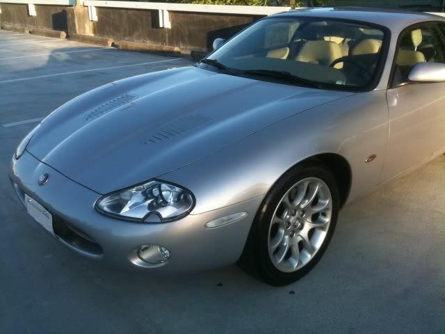

Do you wax your wheels?
You will significantly lower the brake dust buildup if you do.
My double fives used to turn ash-like maybe 3 days after a wash without wax. Now when I was the car I use a foaming alloy cleaner (I recommend Turtle wax or eagle, you want the heavy duty corrosive ones (with the symbol of a hand turning into bone)), spray it on, scrub with a brush, and wash off with a garden hose (do this relatively quickly, don't leave the foam on for more than maybe 2 minutes or so). If there is a specific spot that you're having trouble with you can use a scotch brite sponge lightly, soaked in the alloy cleaner, then again rinse with water. Then, apply wax on the wheel - I use a turtle wax green wax paste with a sponge applicator. Let it dry for a few minutes, polish with a microfibre.
With waxing my wheels now look spotless like new between washes, as opposed to days.
