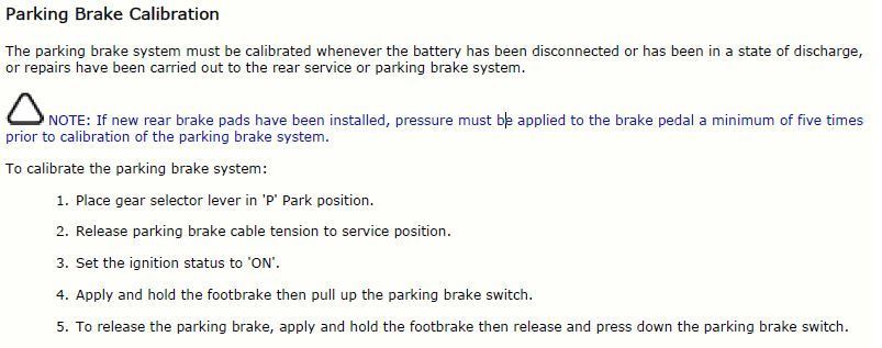

I also do not recall if the rear calipers are supposed to be set to service position with a scan tool or diagnostic system prior to pad replacement. On the X350 supercharged cars they are.
According to the X351 workshop manual, after the rear pads are replaced, the parking brake must be recalibrated, so it may help you to follow the steps below from page 7,404 of the manual. This should thread the pistons back out to their correct operating positions.
