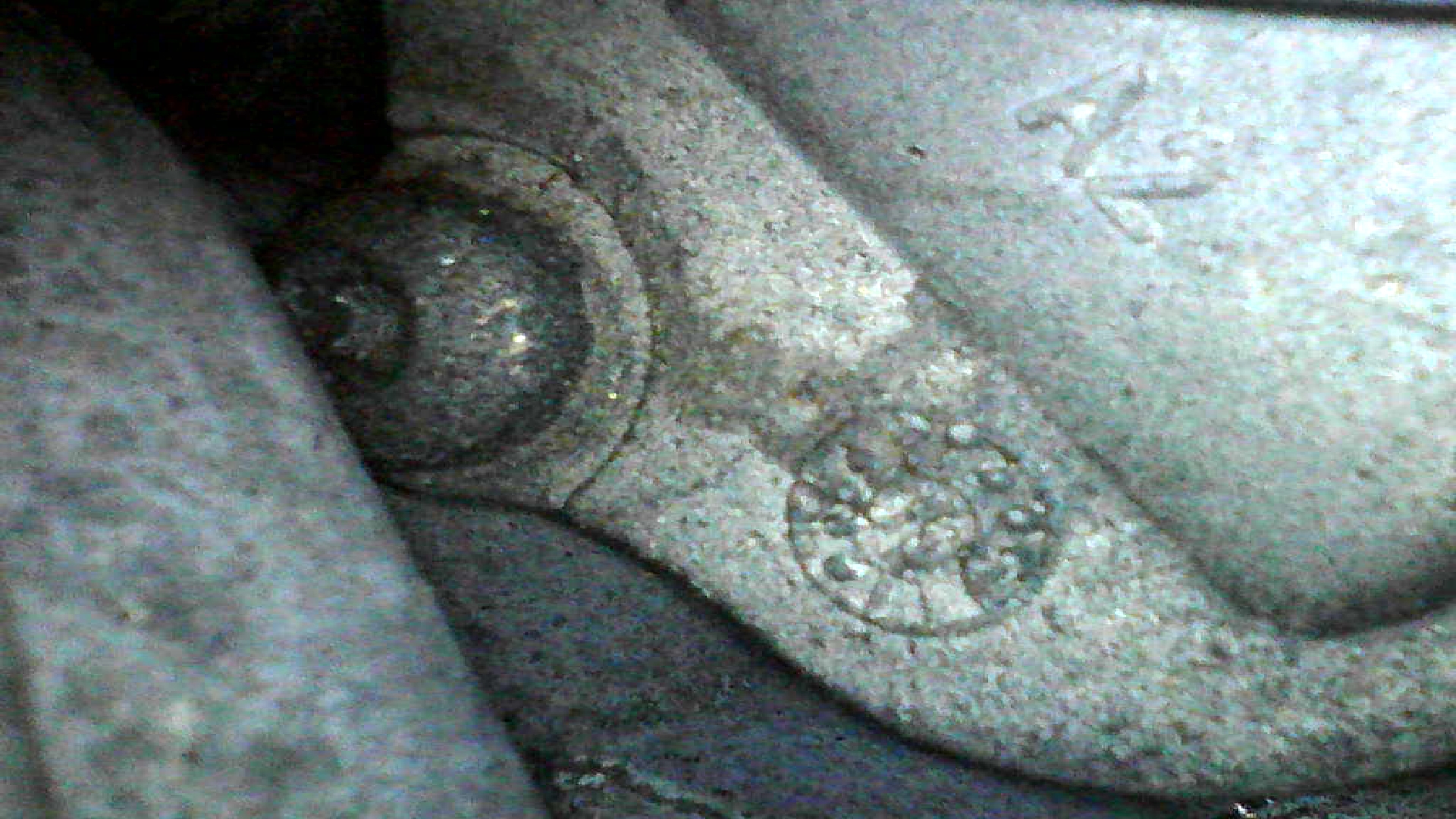

Thanks to @XJsss for the clear picture of where to look. Unfortunately, mine does not have this logo. In fact, I have no idea what this logo is even supposed to be.
Car is 2011 Supercharged with 60k miles. I can't believe it's never been done. But it's definitely not a LR logo

Silvertonesx24 That is the old FoMoCo pump. Look at my first photo at the left edge and you will see a similar stamping. as a matter of a fact I recently had a small coolant leak and purchased a new water pump that I had in my trunk for my Jaguar Dealer Tech to use if he needed it along with a new front crossover pipe and associated bolts and tubes. (my dealer will install proper customer supplied parts as they charge a fortune for parts) Turned out my leak was a heater hose at the back right corner of the engine. He was able to replace that and also used the new crossover pipe I had in the trunk and added a new rear crossover pipe as we were replacing seeping cam cover gaskets.

Thanks, not the greatest news, but better news finding about it now rather than on a failure. Looks doable DIY at least. With all of the failures I've heard around 30k miles or so, can't believe mine has lasted this long
