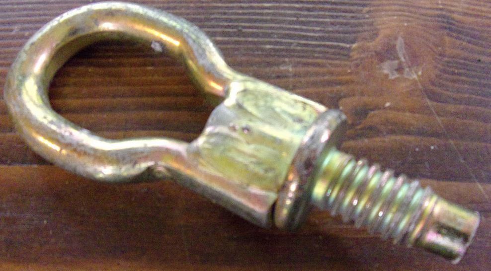

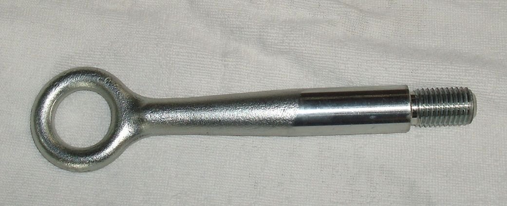

Here it is installed on the front.

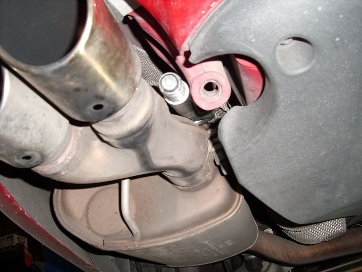

BUT this tow loop will not thread into the rear tow mounting hole??
Here is the loop next to the rear mounting hole. It's just too large to thread in.
I measured the tow loop and got .685" OD on the threads. I measured the threaded hole and got .510" ID. So no way will it fit.

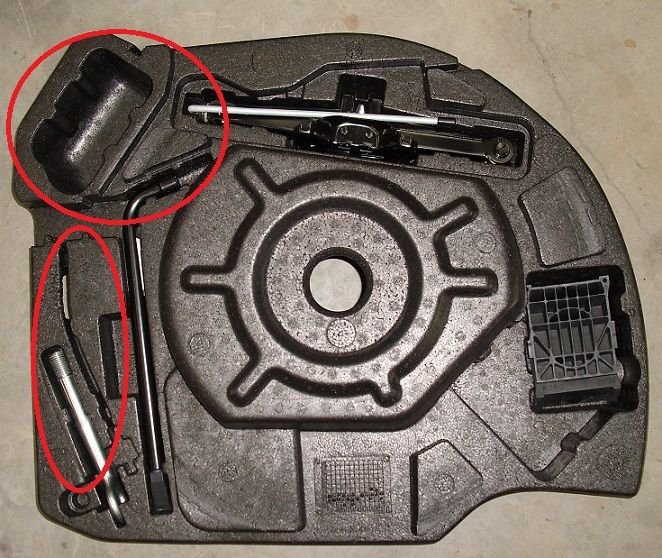

Is there a 2nd tow loop for the back? I wonder because my trunk organizer seems to have some blank spots and may be something is missing?
Is there anything that goes in the spots I have circled in red?

I actually thought the same thing as you, that the trunk organizer was missing things, but the owners manual doesnt actually show anything going in those locations either. Maybe its the same one used in the XF or in Euro cars where there is something for those locations? I dont know, but for now one of them holds that mysterious rear hook.

Looking at the S Type tow loop brings up Part #C2C37723 (Old Part #XR88500 and newer part #C2P1708) and it's listed as 16mm (.629") thread diameter which is very close to the current XJ one which I measured up thread. Actual thread is listed as M16 X 3.0 LH thread.
This tells me that the S Type loop will NOT fit the smaller hole either?

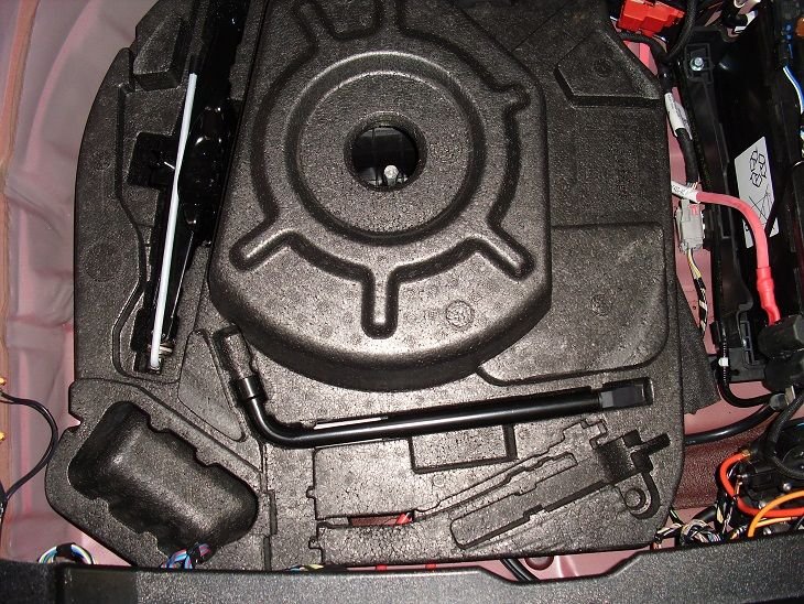

Mine has both in the tray in the trunk. They cut a slot in that circled area in your picture and jammed it in there.
