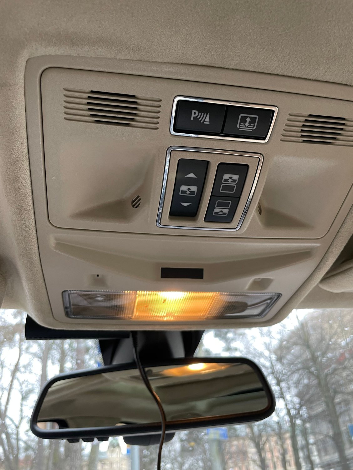

New DashCam - a Blackvue DR590X behind the rear view mirror. I'm planning to connect the cable (in the middle of the picture) to 12V inside the roof panel of my XJL (X351) MY2011. Does anyone know how to disassemble the panel without damaging it?
