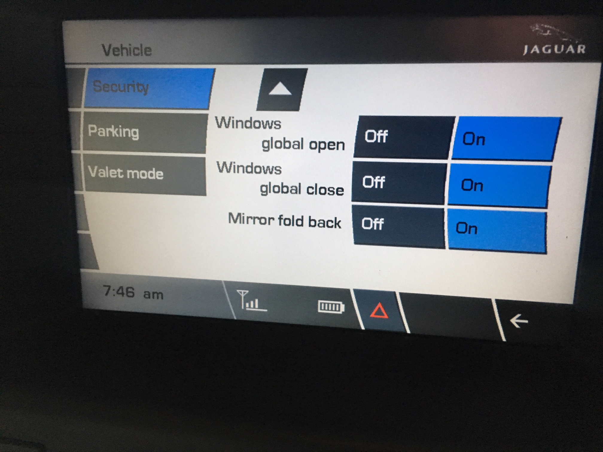

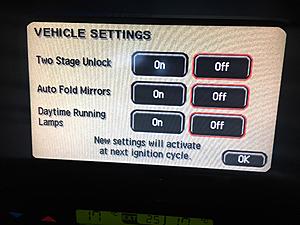

Gonna ask a stupid question, but have you guys looked in the vehicle settings menu on the touchscreen?
The earlier cars have an option in there to turn the folding when locking on or off.

Cambo, The vehicle settings are no longer on the touch screen and are on the screen by the speedo. However, there is no menu or screen like you show.
