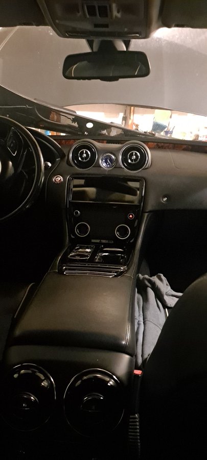

Hi guys,
My Jag is 2017 LWB and it has 4-zone system.
I bought display climate control panel from aliexpress and I received it 2 weeks ago. Easy to install and good to use. It allows you to easily set the temperature, wind speed and seat heating/cooling settings.

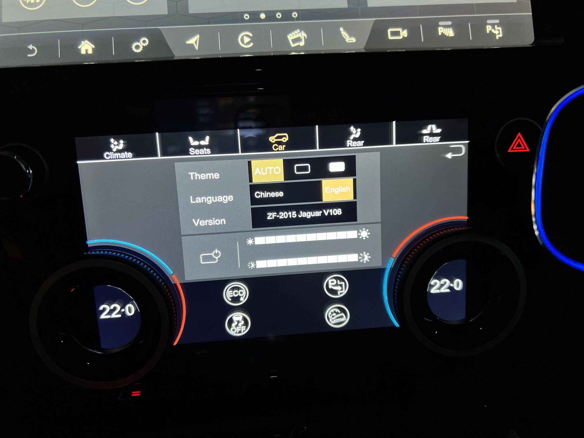

It has very important problem with my Jag. Rear seat control does not work. I think the problem with the firmware. Our HVAC Panel had a "big" software update at 2016. That's why if we install a 2015 panel on a 2016, some features will not be available. My firmware is ZF-2015 V106. I'm guessing it is the firmware for pre-facelift models. By any chance, does anyone use the same product? The seller is not answering my question, now
If anybody has new firmware or other informations, please share with me.

Hey I just bought 1 of these units & if your problem haven't been solved with the rear seat controls try this:
Go to the settings screen like in the photo you have posted above & then press & hold on the version for a few seconds & it should take you to a hidden menu... where you can then make changes to the system ..

Watch these video files, please. There are two problems. Of course I know hidden menu and I tried It has nothing to do with turning the feature on or off. I turned on all the necessary features for my jag.
First, the auto de-fog didn't work. (I switched to Chinese for sending to Chinese sellers.)
Second, rear seat climate control does not work well. In the display, I set it to Auto, but the Auto button does not light up and it is not pressed. The temperature control function is also unnatural.
I think this is a firmware issue. They seem to have made this panel as of 2015. The FL XJ's HVAC panels have different software. This issue can reproduced on XJ produced in 16, 17, and 18MY. (They are my friends) The seller is no longer responding to this issue.

The latest fw is V110. It has solved auto de-defog function, but rear control yet, 16my later.
