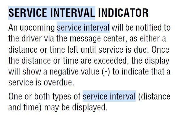

In the XJ owners manual they state it's time and distance. But as usual no indication of how long a time or how much distance is needed to turn the service indicator on?
Anyone know? It does seem to be a year or so on my car?
