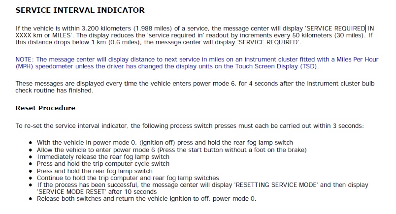

Here is the explanation of how the SERVICE INTERVAL INDICATOR operates and the reset procedure:
It's a 'nag' message and not a sophisticated monitoring system indicating a fault.

Ok , I have tried doing this set of instructions at least a dozen times in past 2 days and nothing happens. Also the message service required in xxxx miles was never displayed prior to service required message coming up. Don't know if that has anything to do with it. Suggestions? thanks again

You have 3 seconds, that's the trick. The split second you press starter, immediately press trip indicator and rear fog button. I mean immediately!!

okay, do you keep the rear fog lamp pressed while you press the start button then let it go and repress it at the same time you press the button in the turn signal stalk which is the computer trip set button?

Yup, that's it

Does this procedure work on a 2009 XK? I've tried at least 25 times with no luck! And I'm quick like a ninga!

That procedure was originally documented for the XF, so it's possible that it only works on later XKs. Rahtok and scm said it worked on their 2010s, HouTexJag said it worked on his 2013. Brutal (certified tech) said it should work on all XKs.
