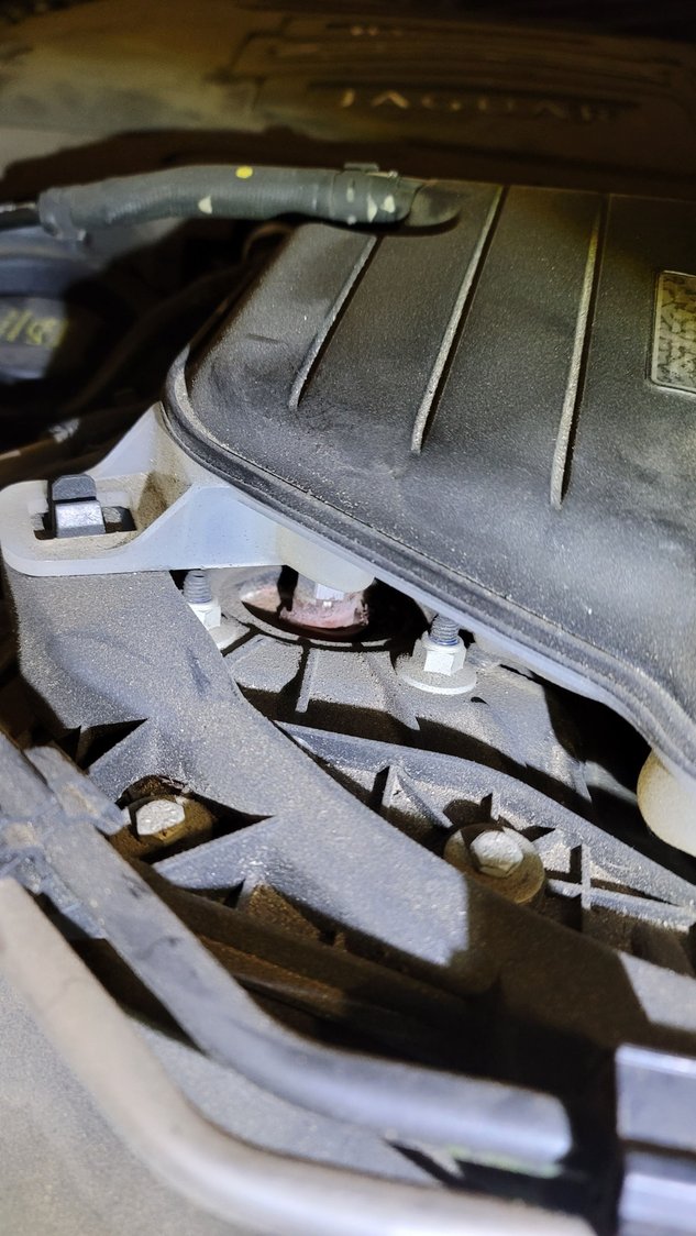

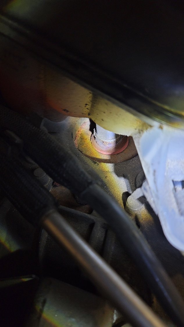

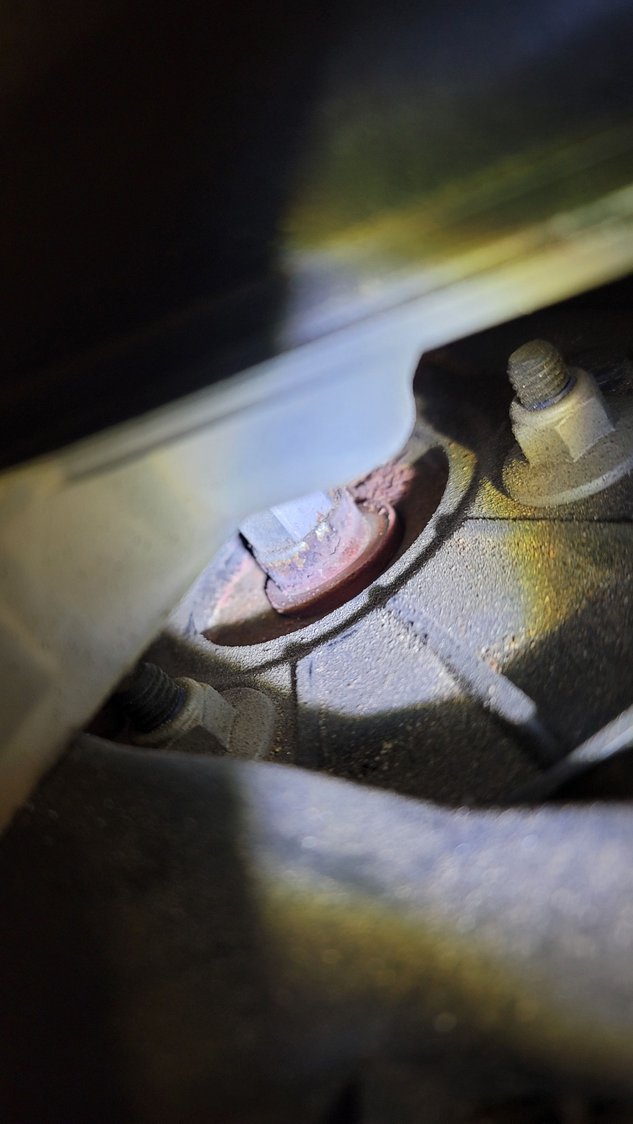

Here are pictures of the top of the struts. The rubber piece doesn't look worn. What do you think?

The orange granules that are collecting on top of the shock mounts are a tell tale sign that they are on the way out.
As an aside, your coolant is low.
