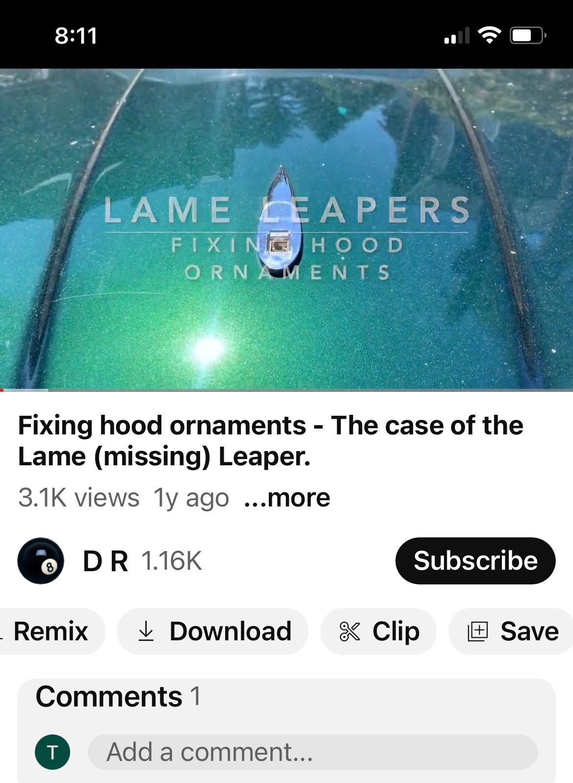

Thank you for your response. I have looked at a few YouTube videos, and your assessment seems on target.👍

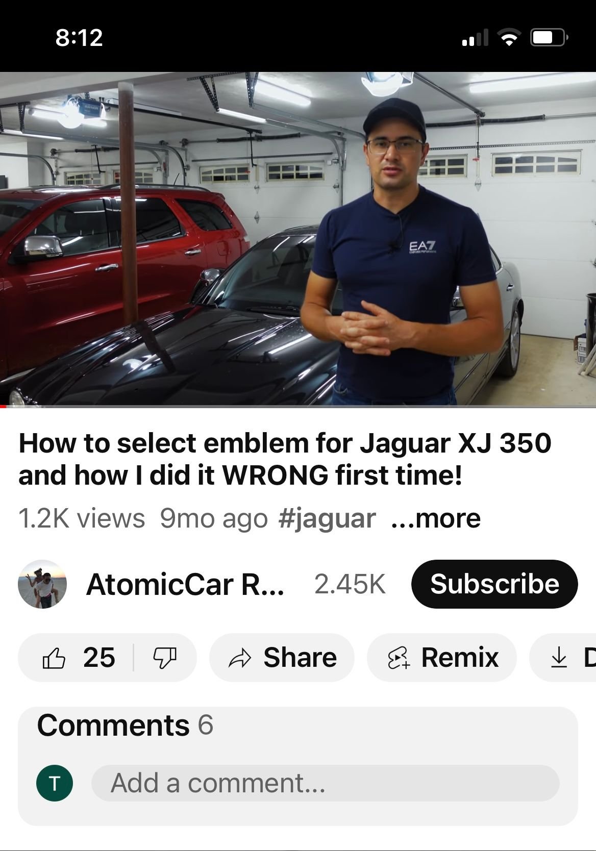

I purchased my Leaper for my 2017 XJ jaguar. It was an authentic factory Leaper for the Jag 2017 XJ. I did some research and made sure it was authentic. If you go on YouTube, they will display various leapers to show you the difference for which ones are authentic. Fortunately, I had the original Leaper that fell off at the car wash that Jag put on the car when I purchased it. I was able to find a foreign auto repair shop to install my leaper for $200. It took 2 hours to reattach it. Jag wanted almost $500!
Authentic Jag Leaper
Leaper Install
