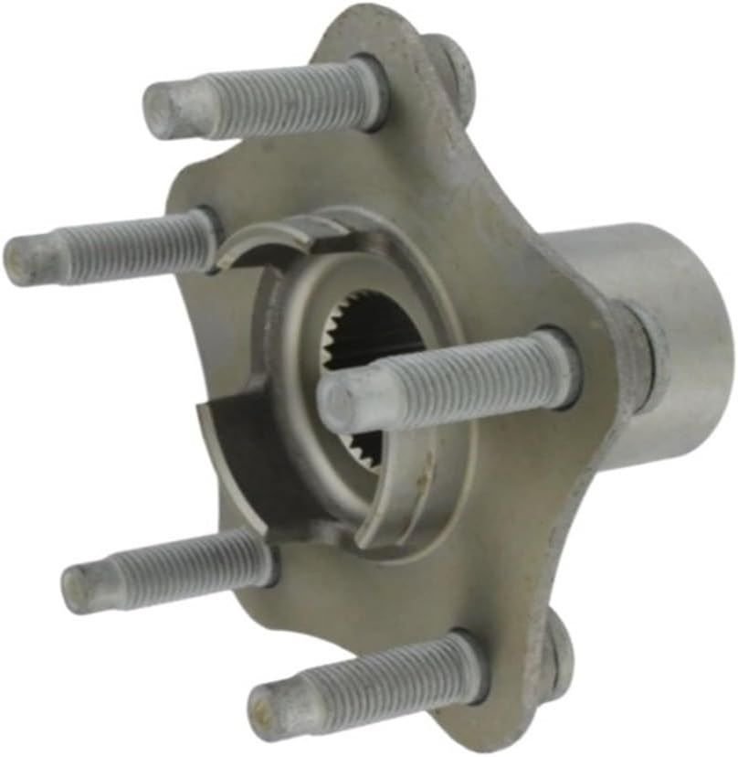

Here is a real rear hub and I found it on Amazon! But not available anymore. You can see these are conventional wheel studs and install like any other ones.
They are about $200-$250 new. Would you consider a used hub? I do see them on EBay for around $100 and the good news is it looks like that part was the same for the entire XJ production and used as well in XF's, XK's and F-Types.
I do see they superseded part number to C2D60511 which is about the same price.
